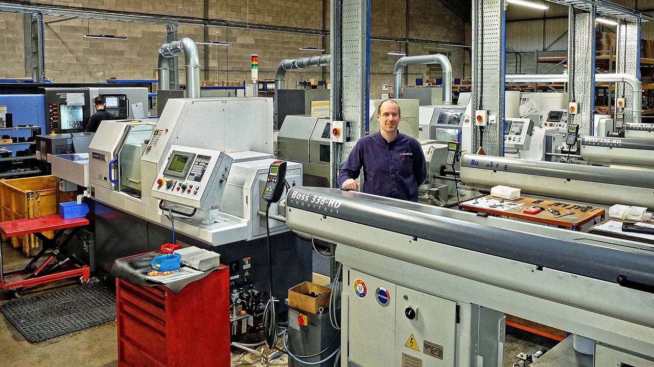

Since moving premises in Bicester at the beginning of 2015, subcontractor SRD Engineering has approximately trebled its turnover and headcount, a rate of growth that accelerated during 2018 due to the arrival of three new sliding-headstock (Swiss-type) CNC turning centres from Citizen Machinery.
Joining a 20 mm bar capacity Citizen Cincom L20 Type VII lathe installed in 2009, which helped the contract machinists to weather the recession, two further models for processing similar size stock were installed in March and August last year, followed by a 32 mm capacity machine in November. It is noteworthy that the decade-old lathe is currently running 24/7 and still holding tolerance well.

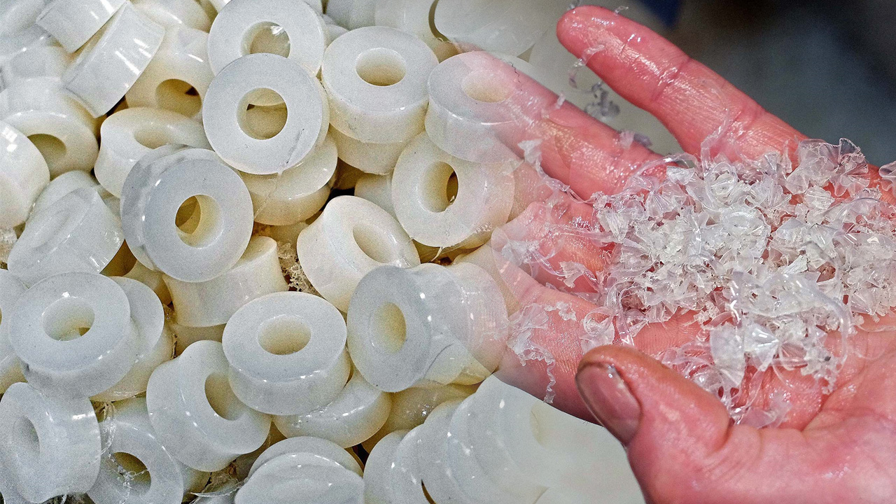

To help achieve this level of accuracy reliably, even during unmanned running, all of the latest sliding-head lathes are equipped with Citizen’s LFV (low frequency vibration) functionality – www.youtube.com/watch?v=2tpgc_pHRl4. The patented system allows stringy swarf generated when machining aluminium, stainless steel, nickel alloys, copper and plastics to be broken into shorter chips, the length of which can be controlled by the cutting program.

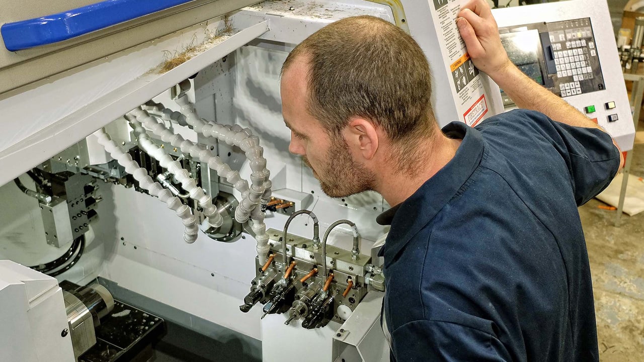

“With LFV, which acts in two CNC axes simultaneously and is part of the control’s operating system, as distinct from a macro in the part program, it is possible to regulate chip size closely without compromising the life of the cutters – in fact, they tend to last longer and break less often.”
He explained that not only can the length of the chip be specified in any given program according to the material being cut, but LFV can be applied to different parts of the cycle, for example when turning a deep groove in stainless steel, an operation that is particularly prone to producing a tangle of swarf. It avoids a ‘bird’s nest’ forming around the sub-spindle and inhibiting synchronous component pick-up for reverse-end machining, or entanglement of a tool leading to its breakage or compromised component accuracy and surface quality.
The reason LFV is not necessarily applied continuously to a whole program is that the technology lengthens slightly those parts of the cycle due to repeated periods of air cutting lasting microseconds. It is this action that breaks the swarf into short chips and it also has the effect of improving penetration of coolant to the cutting zone, which is a prime reason for the extended tool life.
If a job is particularly price-sensitive, LFV use can be minimised or even switched off during manned operation, but the system is so flexible it can be reintroduced for lights-out running to ensure a full ghost shift’s production in the bin the next morning, without fear of stringy swarf impairing turning and drilling efficiency and possibly recycling from the conveyor back into the working area and jamming the machine. Thus a weekend’s worth of parts can be reliably produced, whereas without LFV there is a likelihood of only four hours of output before the lathe stops automatically in the absence of an operator to clear the swarf.

As a rule of thumb, they noted that the cost of a Swiss-type lathe is around twice that of a fixed-head machine, but the former is able to produce twice as many parts, allowing a subcontractor to invoice around double the amount per month per machine compared with fixed-head capacity. Earnings per pound invested is therefore equivalent. The big saving is that one operator is able to attend all four of SRD Engineering’s Cincom sliding-head turning centres, whereas to achieve the same output from double the number of fixed-head lathes, which have to be individually manned for F1 work, eight operators would be needed, resulting in much higher labour costs.
