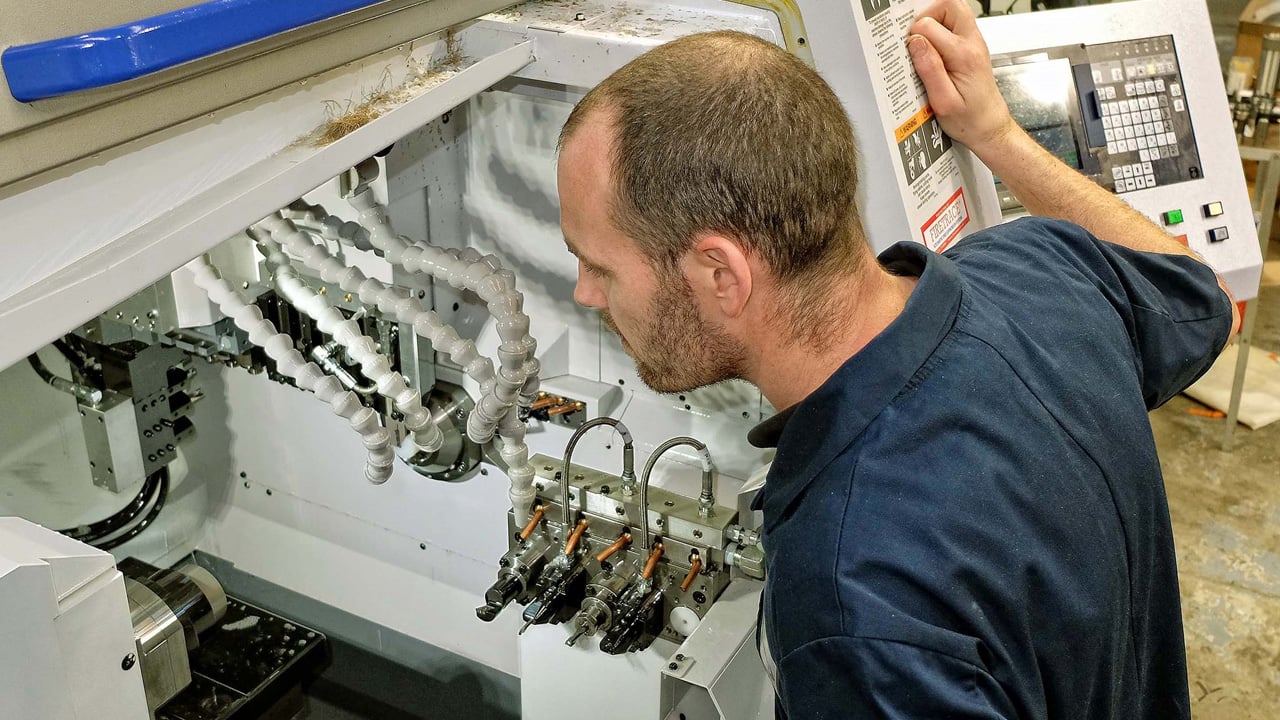

Joining a 20 mm bar capacity Citizen Cincom L20 Type VII lathe installed in 2009, which helped the contract machinists to weather the recession, two further models for processing similar size stock were installed in March and August last year, followed by a 32 mm capacity machine in November. It is noteworthy that the decade-old lathe is currently running 24/7 and still holding tolerance well.

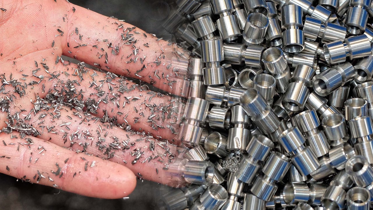

To help achieve this level of accuracy reliably, even during unmanned running, all of the latest sliding-head lathes are equipped with Citizen’s LFV (low frequency vibration) functionality – www.youtube.com/watch?v=2tpgc_pHRl4. The patented system allows stringy swarf generated when machining aluminium, stainless steel, nickel alloys, copper and plastics to be broken into shorter chips, the length of which can be controlled by the cutting program.

He explained that not only can the length of the chip be specified in any given program according to the material being cut, but LFV can be applied to different parts of the cycle, for example when turning a deep groove in stainless steel, an operation that is particularly prone to producing a tangle of swarf. It avoids a ‘bird’s nest’ forming around the sub-spindle and inhibiting synchronous component pick-up for reverse-end machining, or entanglement of a tool leading to its breakage or compromised component accuracy and surface quality.
The reason LFV is not necessarily applied continuously to a whole program is that the technology lengthens slightly those parts of the cycle due to repeated periods of air cutting lasting microseconds. It is this action that breaks the swarf into short chips and it also has the effect of improving penetration of coolant to the cutting zone, which is a prime reason for the extended tool life.
If a job is particularly price-sensitive, LFV use can be minimised or even switched off during manned operation, but the system is so flexible it can be reintroduced for lights-out running to ensure a full ghost shift’s production in the bin the next morning, without fear of stringy swarf impairing turning and drilling efficiency and possibly recycling from the conveyor back into the working area and jamming the machine. Thus a weekend’s worth of parts can be reliably produced, whereas without LFV there is a likelihood of only four hours of output before the lathe stops automatically in the absence of an operator to clear the swarf.

The impetus last March for installing a 7-axis Cincom L20 Type XII LFV with a Y-axis on the counter spindle and a 135-degree B-axis spindle integrated into the gang tool block for both front and back machining was down to the original Swiss-type lathe being fully occupied, while enquiries kept coming in for large volume runs of typically 10,000-off per month. One of the contracts won involves producing a two-part, press-fit assembly with a threaded insert that forms a stainless steel oil restrictor used in the aerospace industry.

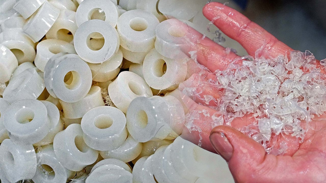

With this in mind and having received a request to quote for producing 10,000 one-inch diameter Nylon fasteners per month, a 32 mm bar capacity Cincom L32 Type VIII LFV was sourced from Citizen last November and has been machining the parts ever since. Here again, low frequency vibration chipbreaking has proved invaluable for keeping production going during periods of unattended running.
