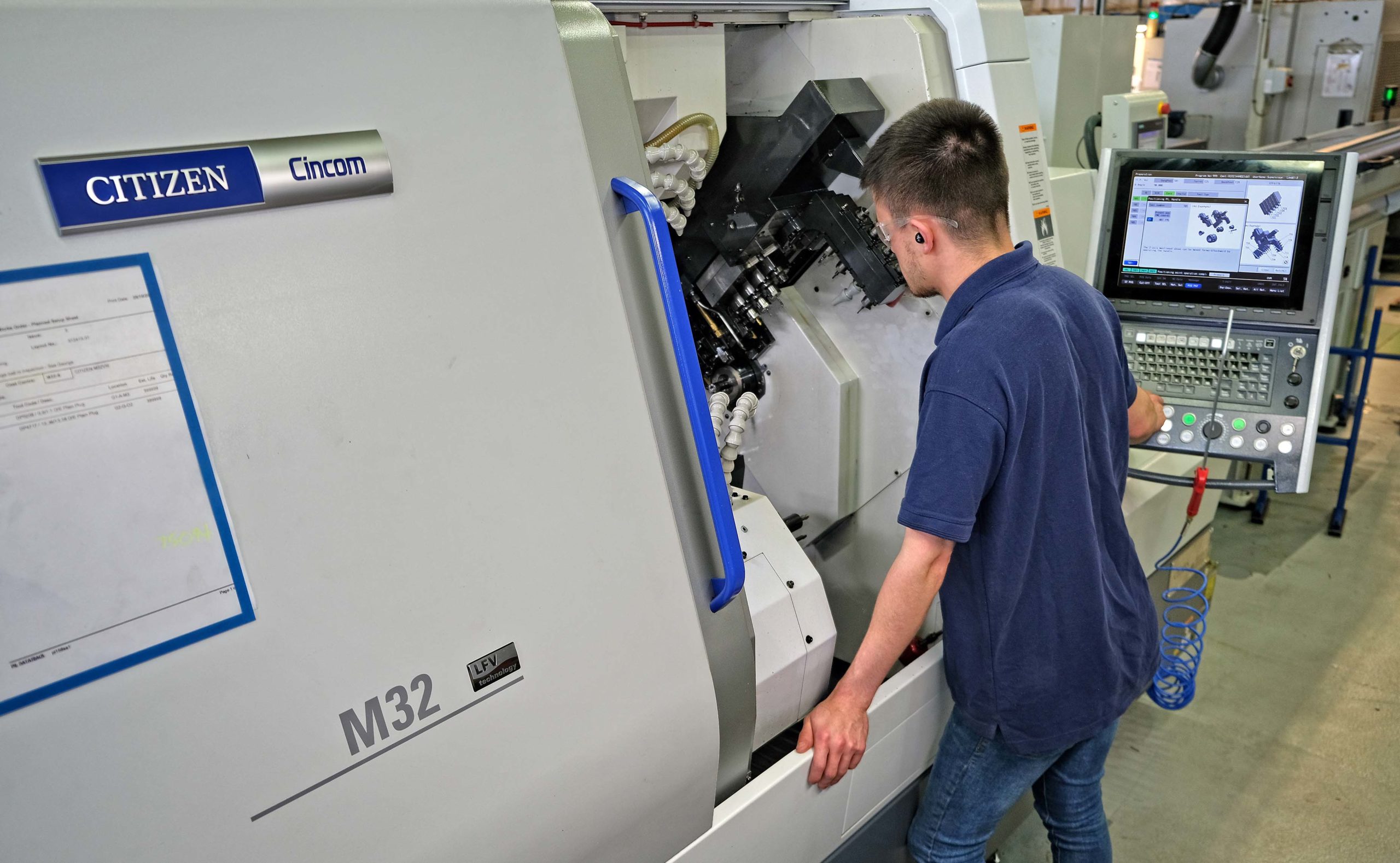

“It is a similar story on the 32 mm machine, which is more user-friendly than the former generation lathe and has better access and visibility into the machining area. Moreover, the addition of a rotary B-axis on the gang tool post enables us to machine more complex parts than was previously possible on our sliders.”

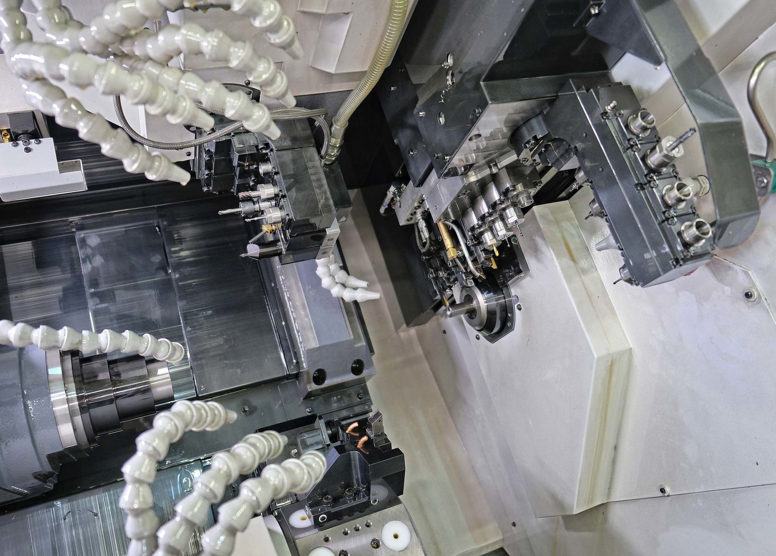

LFV programmable tool oscillation for automatic chip breaking
A notable technological advance from Citizen since DP Engineering purchased the earlier Cincoms was the introduction five years ago of its proprietary LFV (low frequency vibration) chip breaking software running in the Mitsubishi control. It has resulted in a significant increase in productivity when machining malleable materials such as titanium and stainless steel.
It is particularly beneficial for the subcontractor, as one-third of its turnover is derived from the aerospace sector in which the use of such materials is commonplace, as it is in the medical industry, which has also generated more work since the start of the pandemic. Normally during machining, stringy swarf often entangles itself around the tool and component, risking damage to both and necessitating lathe stoppage to clear it from the machining area.
Mr Anthony explained, “The first L20 we bought in 2019 has LFV. We knew about the technology and sent a team of engineers to Citizen Machinery’s Brierley Hill centre to see demonstrations of the chip breaking function in action.
“For certain parts of cycles, it is very effective at ensuring that what usually becomes a bird’s nest of swarf is broken up into shorter chips, avoiding having to stop the machine to remove it and the consequent loss of production.
“The best part is that LFV can be programmed to stop during a cycle when it is not needed by inserting a G-code, minimising the slight reduction in metal removal rate during the periods when the tool oscillates away from the component’s surface to break the chips.
“On some jobs, even when cutting stainless steel, we don’t have to use LFV at all. It depends on the component design, the tolerances that have to be held and the tooling used. However, it is fantastic to have it there for when we need it.”
He added that, in practice, LFV is particularly effective at controlling swarf on the L20s during turning and drilling operations, while on the M32 it speeds roughing and also plays a role when thread cutting. Overall, having complete control over swarf generation ensures that processes are more reliable and repeatable, added to which tool life is noticeably increased.

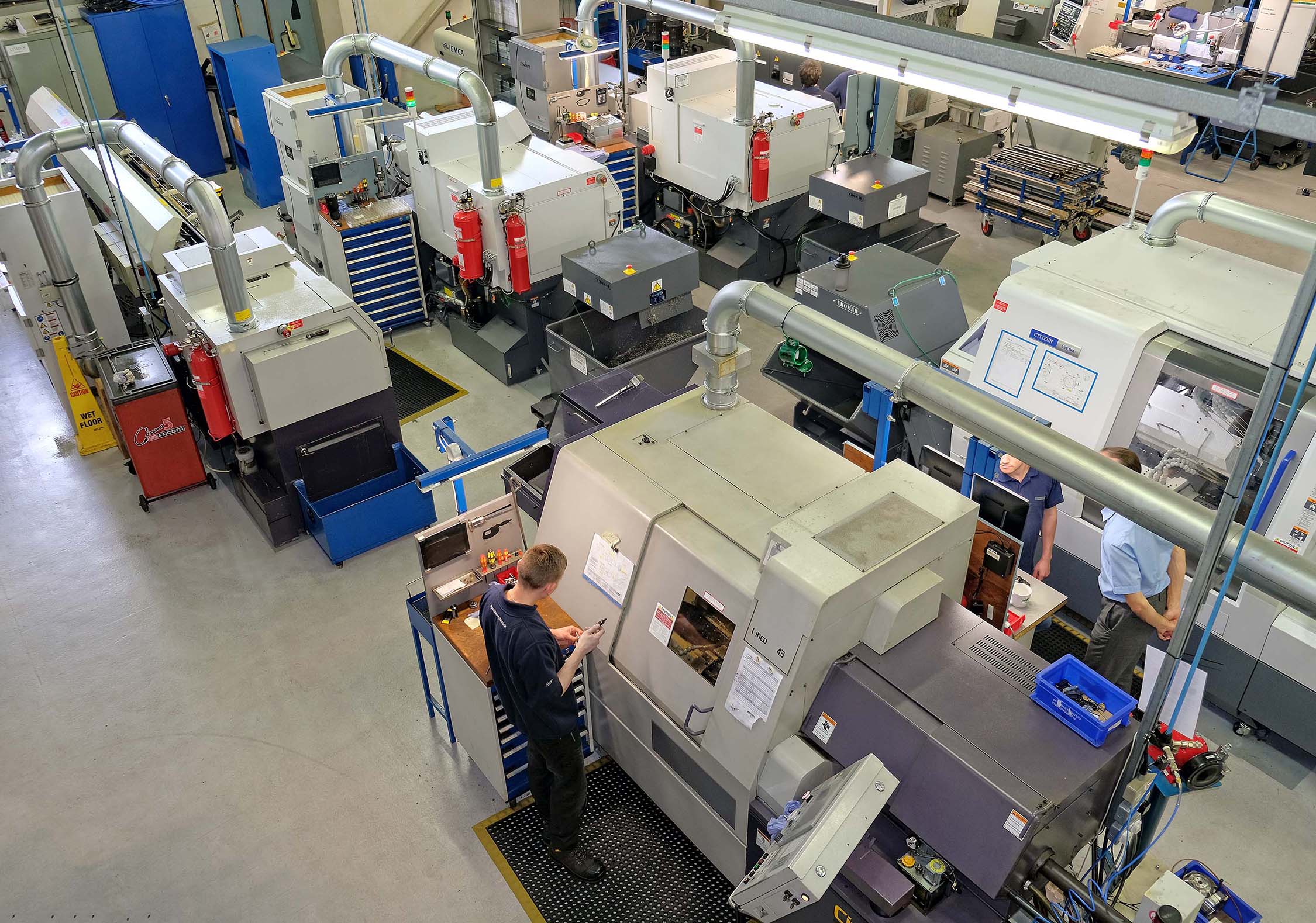

Mr Anthony remarked that overall, taking into account the higher speed of machining, the LFV chip breaking function and the option of guide bush-less operation, the latest three lathes give DP Engineering not only considerably higher productivity but also a lot more flexibility when allocating jobs to the 18 turning machines around the factory, including the current tally of five Cincoms.
A couple of dozen jobs have already been transferred from multi-turret fixed-head lathes to the new sliding-head models for one-hit machining, freeing up the former for other production duties. Such versatility is ideal for a subcontracting environment, leading to faster deliveries to customers, enhanced reputation and more orders.
Mr Anthony also pointed out that as space on the shop floor in Redruth is fairly limited, replacing machines with models that are much more productive is an ideal way to grow the business without the expense and disruption of having to move to larger premises. This is especially important in respect of his turned parts production, which accounts for three-quarters of throughput.
