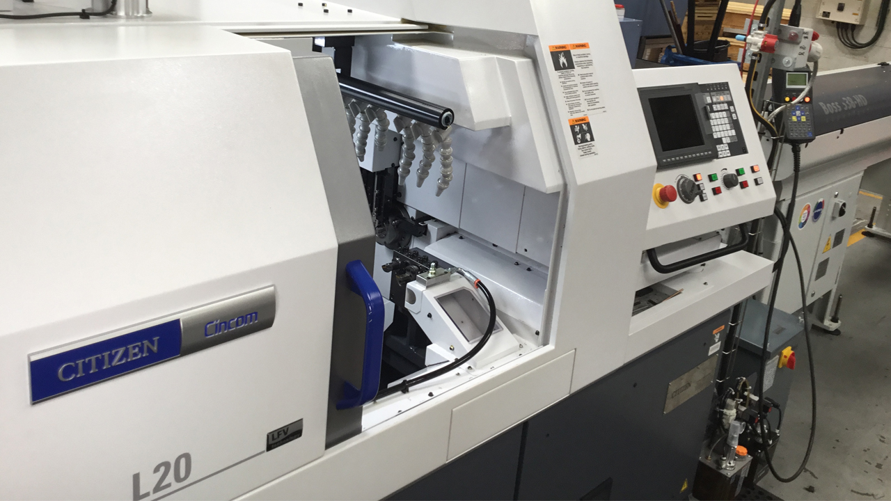

Striving to establish itself as the leading subcontract manufacturing business in the South West of England, Metaltech Precision Engineering Ltd is certainly heading in the right direction with three factory extensions in the last 20 years and over £3m invested in eight machine tools in the last three years. Part of this recent investment drive has now included a new L20 LFV sliding head turning centre from Citizen for tackling a particularly challenging long-term project manufactured from Swedish Iron.

Supplied with all the tools and parameters that are applied at Metaltech, Citizen cut the material without the LFV (Low Frequency Vibration) system – and they knew they had a battle on their hands. Numerous tests were conducted and by applying the LFV cutting technology, Citizen reduced cycle times by over 30% whilst gaining a similar improvement in tool life. “We used to get 30 components per edge and now we get over 100 and the surface finish has also improved.”
