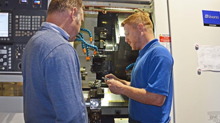

Since its installation, the BNE-51SY6 has not stopped producing components with the machine running seven days around-the-clock.  During the night and weekends, machine monitoring creates a call-out and immediate return to the workshop.  Said Matthew Birley: “The capability of the machine to hold so many tools on the two 12-station all-driven turrets means we can easily accommodate a suite of common tooling and rarely need to change a toolholder.  As a result, resetting is generally prepared and quick, most operations take less than 40 mins which helps keep our utilisation of the machine very high.”

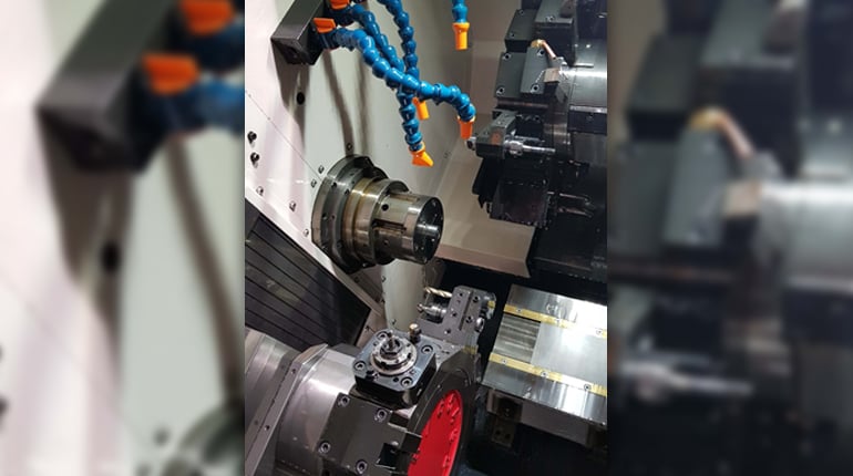

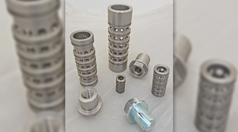

Matthew Birley then follows on to describe one part produced in a 2,000 batch out of 25 mm EN16T bar for use in truck suspensions.  “We held 0.025 mm in the bore and 0.02 mm on the outside diameter which has a 0.8 CLA surface finish without any interruptions for adjustment.”  The part involved all tools being able to be used in overlapping operations between the two spindles and two turrets and as he said:  “… with the power available and the inbuilt rigidity of the machine it was a very straightforward to achieve a totally balanced machining cycle between each spindle.”
The part involved turning, drilling and counterboring, the rolling of an M10 internal thread, the milling of an 18 mm hexagon that were all completed in a 2 minute cycle.  As Davturn has found, the level of power to the driven tools of 2.2 kW delivering 25 Nm of torque and speeds of up to 6,000 revs/min has enabled cross machined features to be very effectively produced.

As Mr Birley commented: “Investing in the Miyano and with the level of support from Citizen’s application team means we are now riding a high.”  He then adds details of a further contract won following the machine installation. This involves a six part series of hydraulic valve sleeves complete with spools between 16 mm and 30 mm diameter in 440-C stainless steel.
