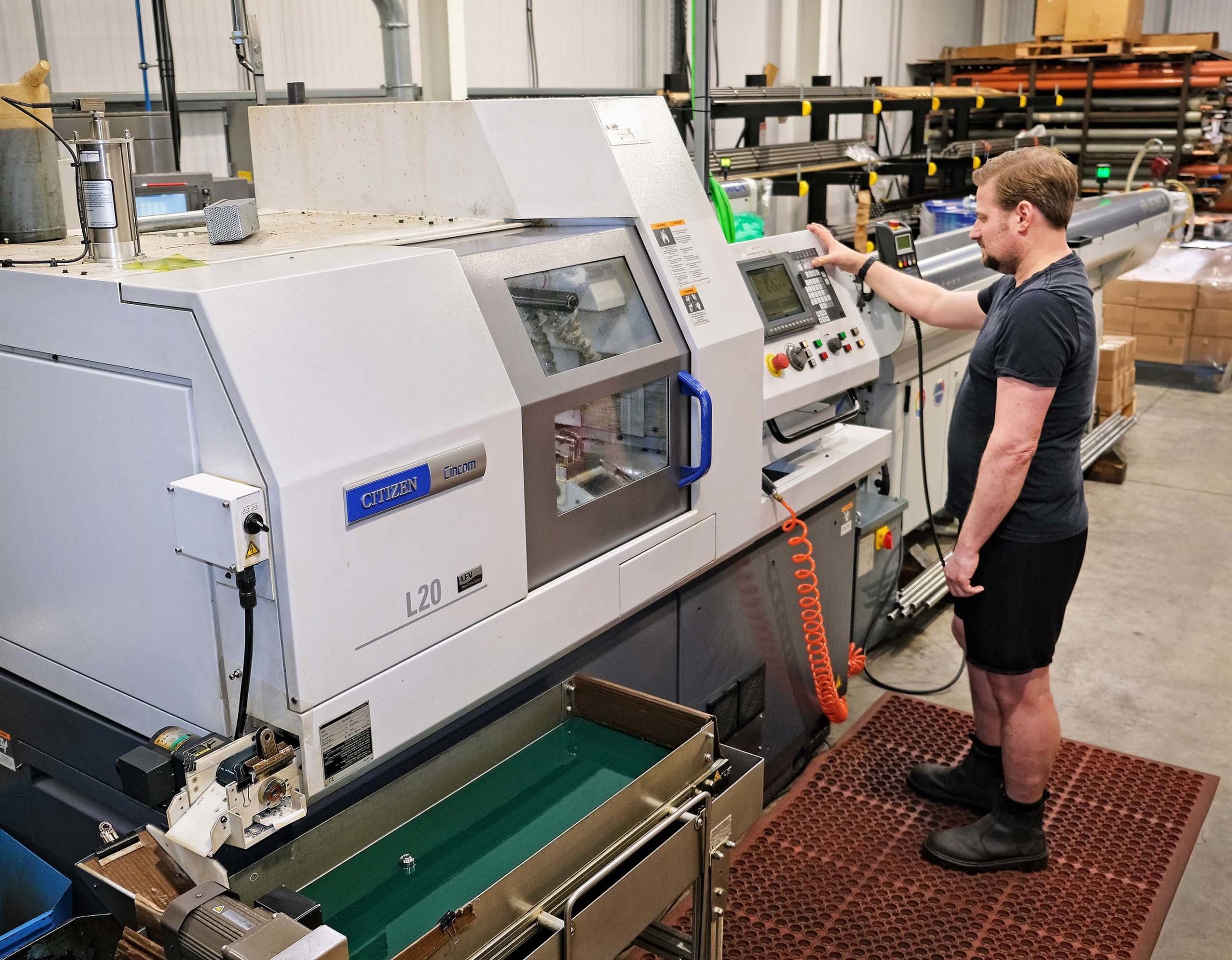

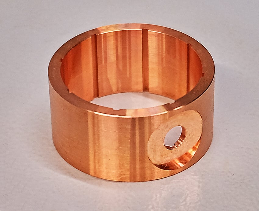

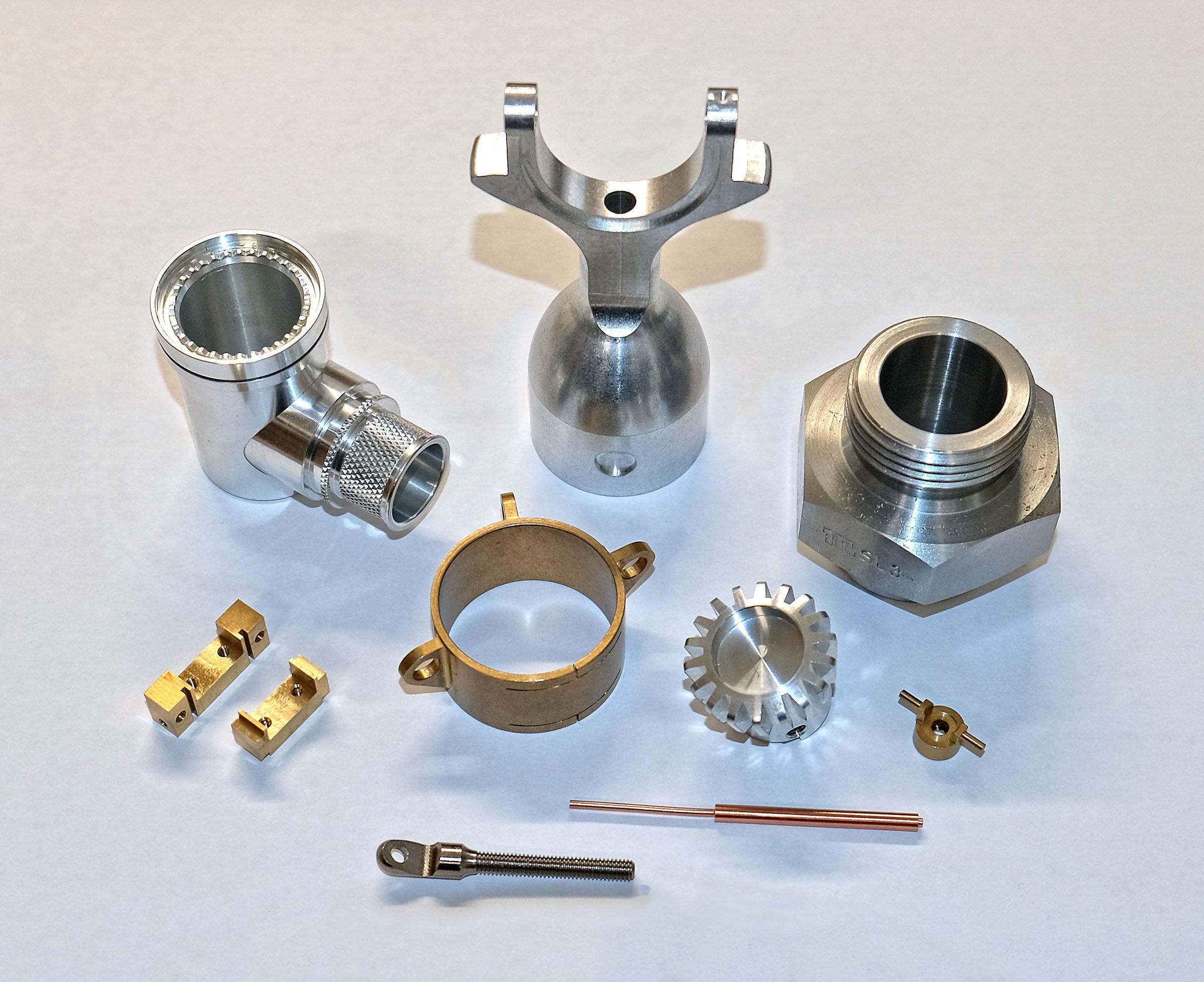

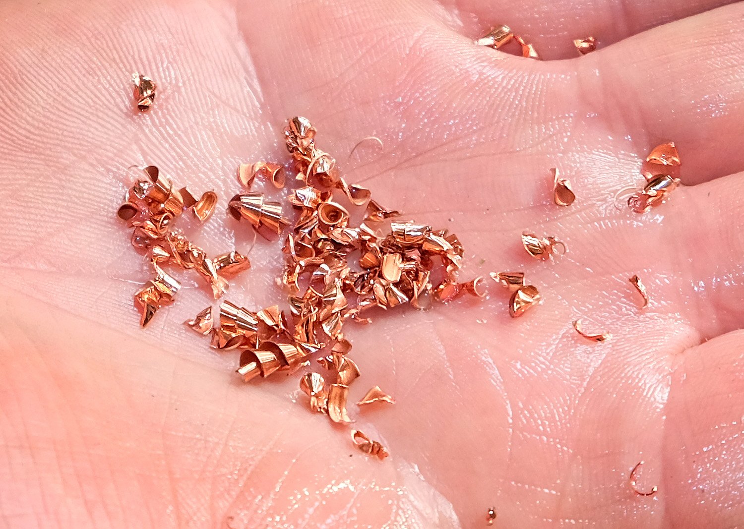

A large proportion of work going through subcontractor C&M Precision’s Maldon factory involves machining copper bar fed into CNC mill-turn lathes. Two sliding-head models out of the nine turning centres on the shop floor, all of which have been supplied by Citizen Machinery UK, have LFV (low frequency vibration) functionality in the operating system of their Mitsubishi controls. It results in much higher productivity and increased yield when converting malleable copper into high-end electronic components for OEMs in the medical, radar, satellite and broadcasting sectors.

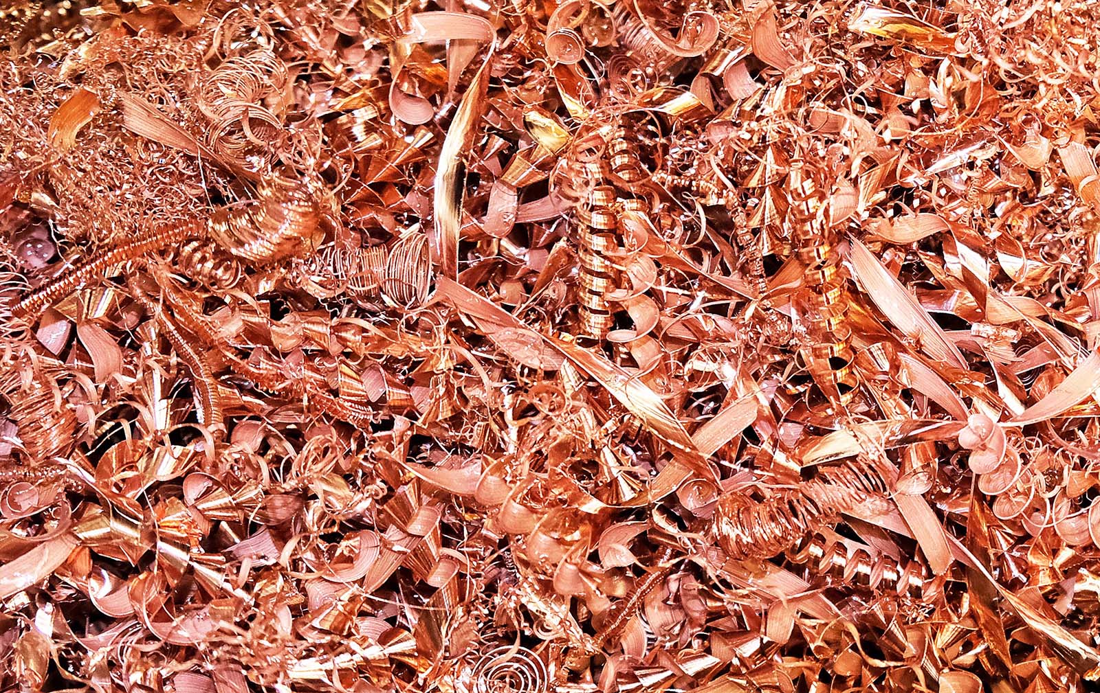

Owner John Cable explained that for many of these jobs, a particular grade of copper known as OFHC (oxygen-free high conductivity) has to be used, which is more than 99 percent pure. One 60 mm long, tight-tolerance component previously produced from 3 mm diameter bar on an early Citizen Cincom M16 slider without LFV had to be turned in one pass through the guide bush down to 1.20 – 1.22 mm diameter along half its length. The continuous string of copper swarf frequently damaged the component and often became lodged in the counter spindle, preventing synchronous transfer after part-off and causing the machine to alarm out. Productivity was severely impacted and up to 20 percent of parts had to be scrapped.
Mr Cable enthused, “Transferring the job to a Cincom L12-VIILFV we bought in 2019 was a real winner. With the LFV function turned on, the copper chips like brass. Yield is now 100 percent, throughput is high and we can even leave the machine to run unattended.”
The other Cincom slider on site with this chip breaking functionality, a nominally 20 mm capacity L20-VIIILFV, arrived on the shop floor in 2017, making the subcontractor an early adopter of this novel technology. Supplied with a kit that allows feeding of oversize bar up to 25 mm diameter, the lathe is also proving useful for machining other materials that tend to generate stringy swarf, like nickel alloys and plastics, which are regularly turned in the Maldon facility.

The first model to arrive in 2001 was a now discontinued M12, which has been sold on. The first job it tackled was the production of 120,000 brass connectors requiring the milling of 3/8-inch hex flats. Amazingly, due to the rigidity of the lathe that Mr Cable described as “rock solid”, one 6 mm diameter carbide milling cutter completed all of the flats, 720,000 of them, and still had not worn out.

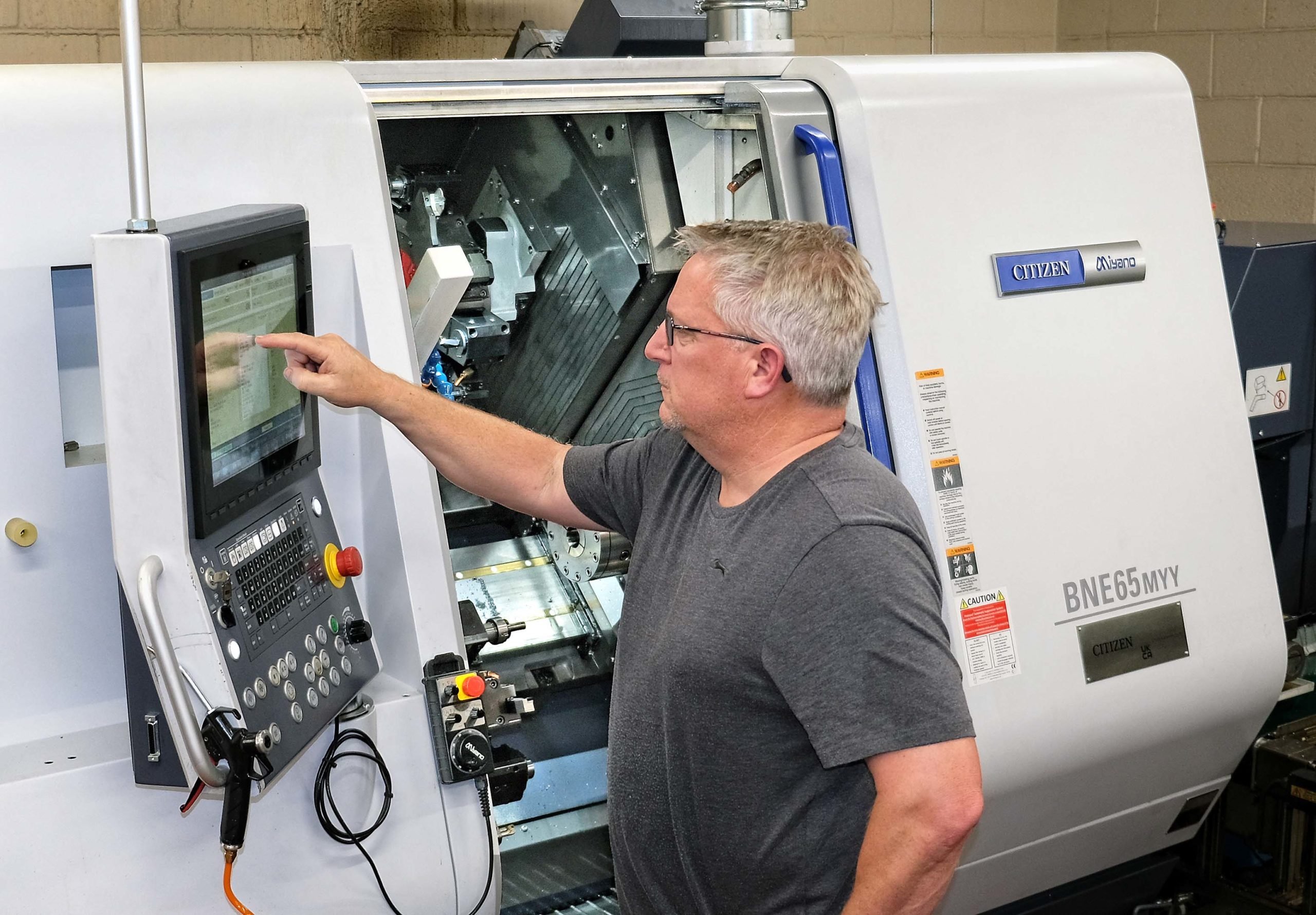

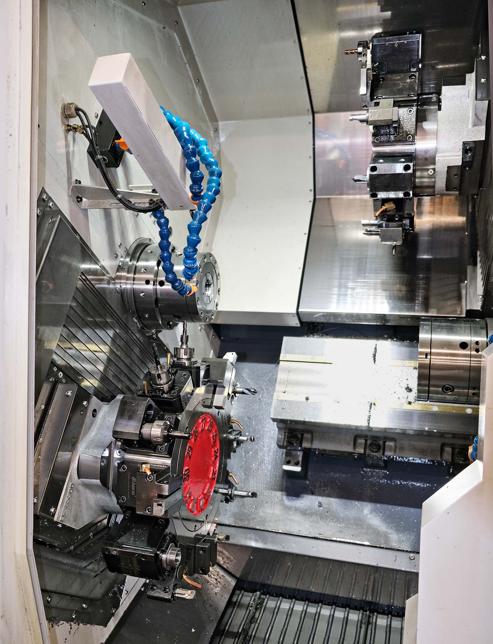

C&M Precision’s latest two acquisitions are from Citizen’s Miyano range of fixed-head lathes. Installed in January and March 2022 respectively, the twin-turret BNE-65MYY models with Y-axis motion on each tool carrier replaced two ageing lathes that had one Y-axis turret apiece.
Mr Cable continued, “It made sense to go the Miyano route in view of our good experience with the Cincom lathes. People say it is not good to have all your eggs in one basket, but in Citizen’s case it is. We now have a single point of contact for applications, backup and service and the supplier is very capable and responsive to our needs.”
He added that the Miyano lathes have similar capability at both spindles and are highly productive, with advantage taken of Y-axis machining for a large proportion of the time. Simple off-centre holes are frequently drilled and bored, flats are easier to mill up to a shoulder and roll marking is often done using the Y-axes. Parts coming off the lathes are accurate due to one-hit production. It is possible to program cycles involving superimposed machining, where three tools are cutting simultaneously, although this facility has not been used so far in the Maldon factory.
Some parts could not be produced at all on driven-tool lathes without Y-axis motion on at least one turret and would have to be put onto a machining centre for a second operation. Others, such as a pair of components – one aluminium and the other brass – for a broadcasting microphone, are produced much faster on the twin Y-axis Miyanos compared with the lathes they replaced. The more complex of the two, the aluminium part, is produced in 4.5 minutes compared with 7.5 minutes previously. As batch size is 2,000-off, the saving is considerable.
