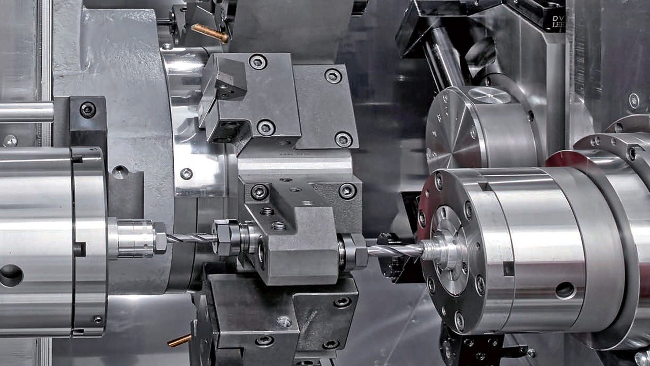

With a view to increasing production output still further, as well as to access the latest technology and provide back-up for the 51 mm capacity lathe, the subcontractor’s first new Miyano, a BNJ-51SY, was delivered in July 2019 by Citizen Machinery UK. As its designation implies, the machine has additional Y-axis movement on the main turret that is proving invaluable for machining off-centreline and providing flexibility and accuracy of milled features.
Mr Aymes cited one component that is produced much more efficiently with this feature. It is a tubular, thin-wall aerospace part machined from solid 304 stainless steel bar of 38 mm diameter. It requires a blind, longitudinal hole to be drilled and bored and the outside diameter (OD) to be turned to leave two lugs. Not only does the Y-axis allow the lugs to be drilled in-cycle, instead of the component having to visit a machining centre for completion, but by being able to program both Y-and C-axis movements into the OD turning, cutter deflection is minimised and accuracy is improved. As the component is required in batch sizes ranging from 200 to 800, the benefit is considerable.

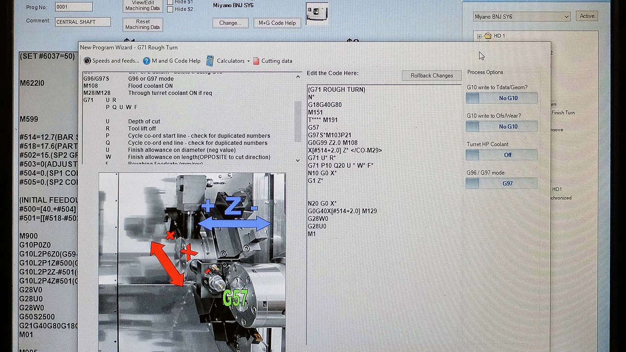

When Citizen installed the latest lathe, it also supplied the subcontractor with the latest version of its Alkart CNC Wizard programming software. It assists and simplifies the creation of even complex cycles using a built-in G-code and M-code library plus reference material and diagrams. Inexperienced users in particular benefit, such as Apsley’s Jay Pritchard, who is halfway through a four-year mechanical engineering apprenticeship. He said he finds the wizard useful when operating the new Miyano if his mentor is not available and the relevant manuals are not to hand. It also helps with understanding how to use the machine.
