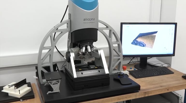

To become more competitive by introducing advanced technologies and processes is the promise of the well-known research center AMRC to industry. Metrology is key to keep this promise and to increase production readiness of new techniques. This is why AMRC recently has acquired its fourth Alicona measuring system.
The development of new manufacturing techniques and technologies has always been the mission of AMRC, the University of Sheffield Advanced Manufacturing Research Centre based in the UK. It “helps manufacturers of any size to become more competitive by introducing advanced techniques, technologies and processes”, AMRC states. To achieve this, metrology is one of the key activities at AMRC. Skilled in many areas of metrology, the team supports the research groups by qualifying novel parts and processes to make sure that they meet physical requirements and industry standards. In the field of optical metrology, Alicona´s high resolution form and roughness measurement systems deliver the greatest benefits than with any other system AMRC experts are aware of. It is not without reason that the globally well-known research center recently has acquired its fourth Alicona measuring system.

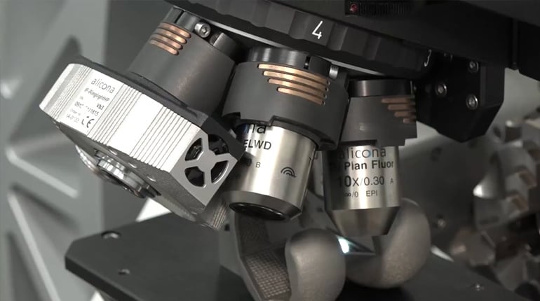

One of various specific aspects in the development of new manufacturing techniques is tool wear assessment. Oliver Hayes, Composite Development Engineer, uses Alicona to see
how the tool is wearing as it progresses through its life. “In composite machining, we generally see that the type of wear experienced by the tool is mainly flank wear. Because of that we need Alicona as I don´t know any other system that allows us to measure the steep flanks of e.g. PCD tools,” he explains. In his daily work, Hayes also needs to measure surface roughness. For him it is of vital importance to measure roughness areal based instead of measuring only a profile of the surface. “In the context of carbon fibre, the Ra value depends on the angle at which you measure it. Because of that, we prefer to use the areal surface roughness value Sa which we easily get with Alicona.” In terms of efficiency and ease of use, Hayes benefits from measurement automation as well. “You can set the system going, have it move to several positions and take surface roughness measurements of several different samples. This is something I really like, and you cannot do this with a tactile CMM”, he concludes.

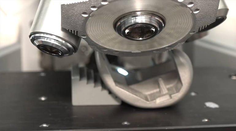

“The Alicona system is ideally suited to small features including small radii and diameters of a hole which are challenging if not impossible with a CMM”, CMM Technical Lead Adam Wiles continues when speaking of the advantages of optical measurement over tactile scanning. An additive manufactured component illustrates the benefits. “We have here an additive manufactured knee joint with a lattice structure on the back surface. This surface is impossible to measure with our CMM, however, it takes only a few seconds to achieve a measurement with Alicona. We measure distances, node distances, string diameters, also surface roughness.” For Wiles, the combination of roughness and geometrical measurements is unique, especially as complex components regardless of industry usually require both for meaningful quality assurance, the measurement of form and roughness. While conventional techniques are capable to do either one or the other, Alicona combines form and roughness measurement in only one high-resolution optical measuring device. “You can do surface roughness on a CMM, but it requires a real specialist kit,” Wiles emphasizes.
