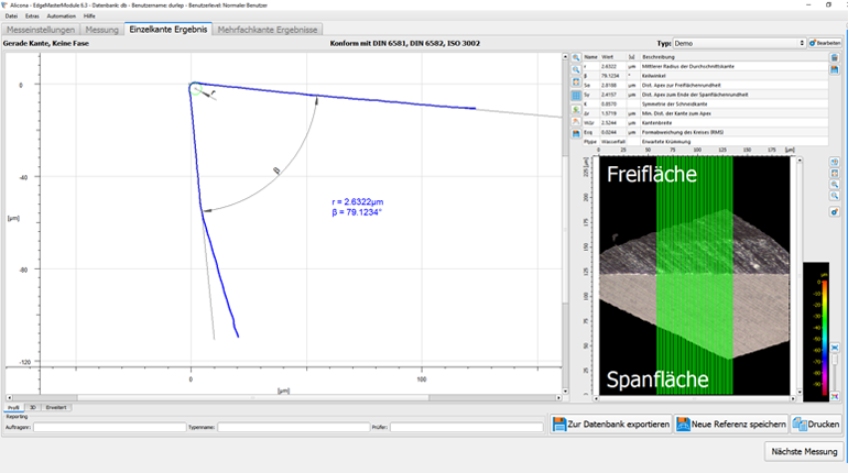

Precise measurements are carried out particularly with regard to geometry and chipping of the cutting edge. This reduces the risk of cracks and improves edge stability. Thanks to the LED ring light, edges with varying surface and reflection properties can be measured quickly and intuitively.
“In addition to the edge radius, we also carry out measurements on all other relevant edge parameters such as clearance angle, wedge angle, and rake angle,” says Ruess. “It was only when we started using Alicona that we became able to verify the almost inaccessible areas just behind the cutting edge.”

Additionally, it is possible to assess chipping along the edge and carry out profile-based and areal measurements of tool roughness. True-color 3D surface visualization provides a detailed view of the strip surface and makes it easy to detect faults. Potential form deviations and tool wear can be identified using difference measurement, which automatically compares the actual geometry to target geometry or a CAD dataset.
