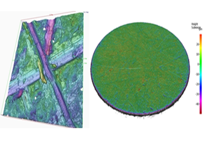

Evaluation of surface deformation, wear intensities and mechanisms

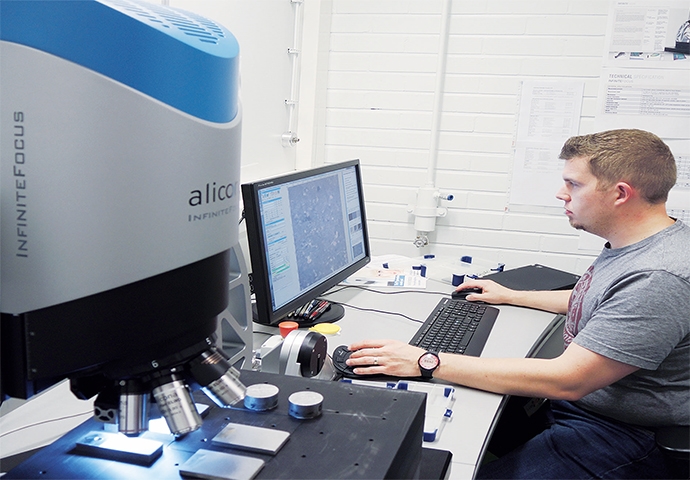

The Laboratory of Materials Science at Tampere University of Technology (TUT) in Tampere, Finland, conducts high-level research on the structure, properties, processing and use of practically any type of material. With the optical 3D measurement system InfiniteFocus G5 they analyze the morphology of surfaces, verify dimensioning, and evaluate surface deformations, wear intensities and mechanisms. In strong collaboration with the industry, a broad variety of technical applications is covered. Measured materials include metals, polymers, textiles, wood, paper, ceramics, coatings and rocks. In addition, the optical 3D measurement system is used for full form measurement of various tools and components.
Since components in materials testing often contain fractured or deformed surfaces, steep flanks or rough surface topographies are regularly encountered. Alicona offers a unique solution to document the entire surface even with these difficult to measure features. “Initially, we were looking for a system that could measure specimens with both large areas of several square centimeters width and rough surfaces, like large wear or fracture surfaces with steep slopes. For us it was also important that the measurement system would be relatively fast. A third requirement was the possibility to do measurements by rotating the specimen and have real 3D datasets as a result”, Niko Ojala and Jarmo Laakso, researchers at the laboratory, explain. ”With InfiniteFocus we have found a measurement system that suits our needs. Due to the high demand and interest towards the system, the utilization ratio has been up to 24/7.”

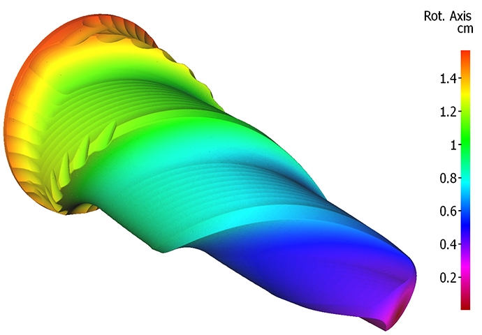

Geometric verification of FSW tools for sealing nuclear fuel disposal canisters
The Applied Materials Science research group at the laboratory offers service for companies in any type of material related projects. “In collaboration with two Scandinavian expert organizations for nuclear waste management, SKB and Posiva Oy, we were able to verify the geometry of a FSW-probe, which is used for sealing nuclear fuel disposal canisters”, Jarmo points out. FSW (Friction Stir Welding) is a welding method in which frictional heat is generated between the tool and a target metal. This causes the metal to soften and weld together by mechanical intermixing. The probe is intended to be non-consumable, so the challenge is to prevent the probe material from melting, while it is traversed along the welding line. Thus, the accurate geometry of it is a key factor for an efficient welding process. With an AdvancedReal3D Rotation Unit in addition to InfiniteFocus they achieve full form measurements of tools and components. This enables members of the research group to measure dimensions like length, diameter and radius, as well as roundness. Radii can be measured down to 2 μm in lateral resolution. The measurements show if components are in accordance to the specified tolerances. Form deviations are evaluated by comparison to CAD data.
“Previously we only had an interferometry system, but it was not able to measure large areas efficiently, in fact it would have needed days to do that. With Alicona we measure areas up to 200 x 200 mm at high measurement speed”, Niko and Jarmo explain. As measurements of large areas often also require long measurement depth z-ranges – as components can either have a curved form, large height differences or highly deformed surface – InfiniteFocus has proven to be the right tool.
Easy quantification of material deformation on large measurement areas
