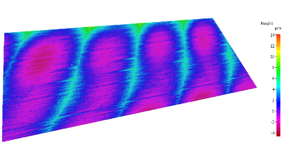

The quality of a tooth flank is determined by both its roughness and its geometry. The roughness of the tooth flank plays an important role in several ways. For example, it directly affects noise generation. The rougher the surface, the noisier the gear. Uniform transmission of motion, on the other hand, mainly depends on the form and positional tolerances of the tooth flank.
It is therefore vital to measure both roughness and form to ensure proper quality assurance of gears. When measuring roughness, it is important to consider the dominant surface structure of gears and choose the appropriate measurement technology for this purpose. Mattias Svahn used an Alicona system, as he knew that mere profile-based roughness measurement would not deliver useful results. "Profile-based measurement allows me to map the surface only partially. Depending on the direction of the profile, roughness values are subject to intense scattering. The resulting measurement values are simply not useful for creating and validating the calculation model," lead researcher and measurement expert Mattias Svahn explains. By contrast, Alicona's measurement systems make it possible to map the roughness of the entire surface, even of the tooth flanks—fast, repeatably, and at high resolutions. The surface texture parameters Sa, Sq, and Sz allow precise assessment of the surface quality.

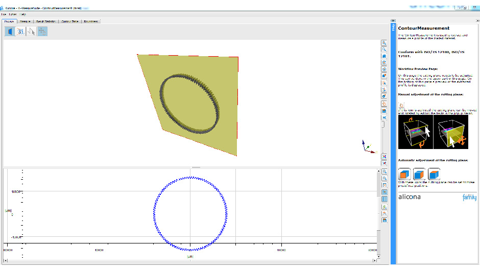

Form deviations can be made visible using difference measurement. This is accomplished by comparing measurement results to a CAD dataset and/or form and positional tolerances

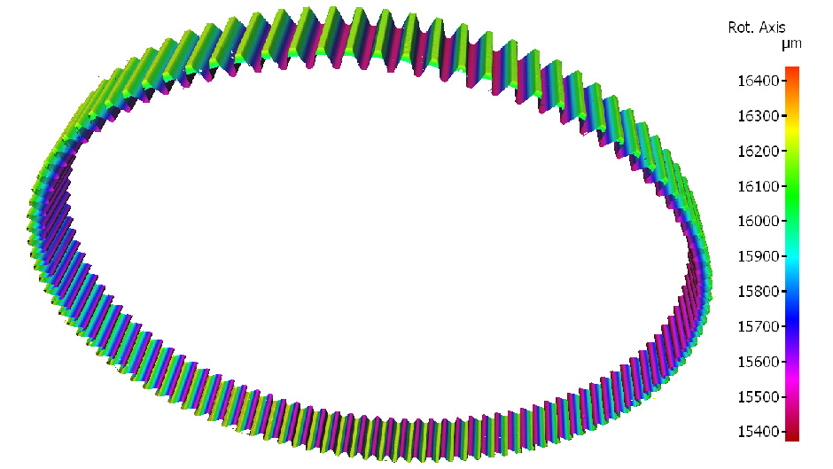

In addition to form and roughness measurement, Lund University also makes use of the visualization of 3D data sets. The large lateral and vertical scanning areas make it possible to map the topography of the entire gear cutting.

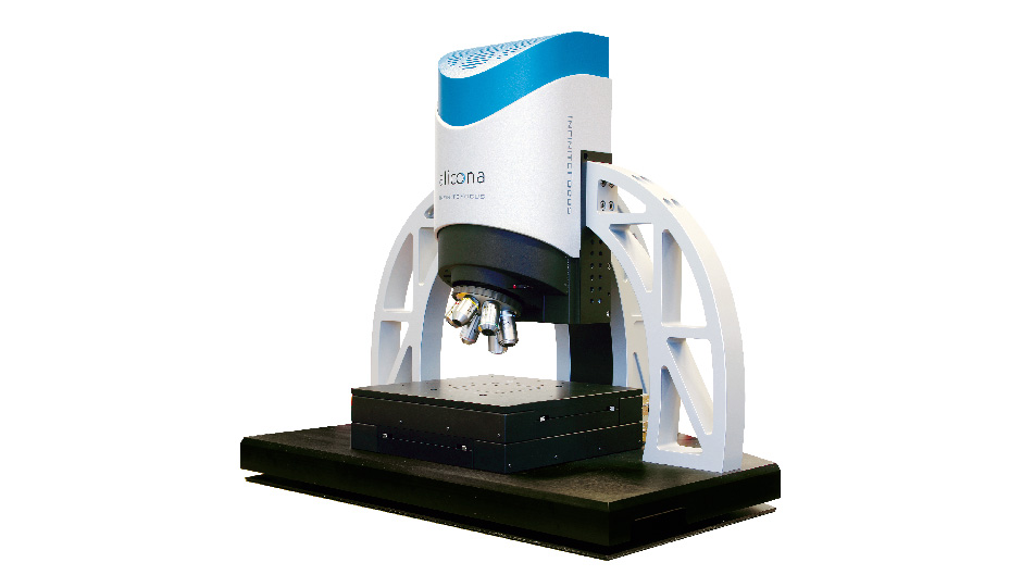

"Thanks to Alicona, we have been able to minimize the time and cost-intensive refining steps of gears. We were blown away by the capabilities of the InfiniteFocus system we got to know at Sandvik Coromant. There is no measurement system we know that is capable of measuring critical form and positional tolerances and roughness of tooth flanks in this way with just one system."
