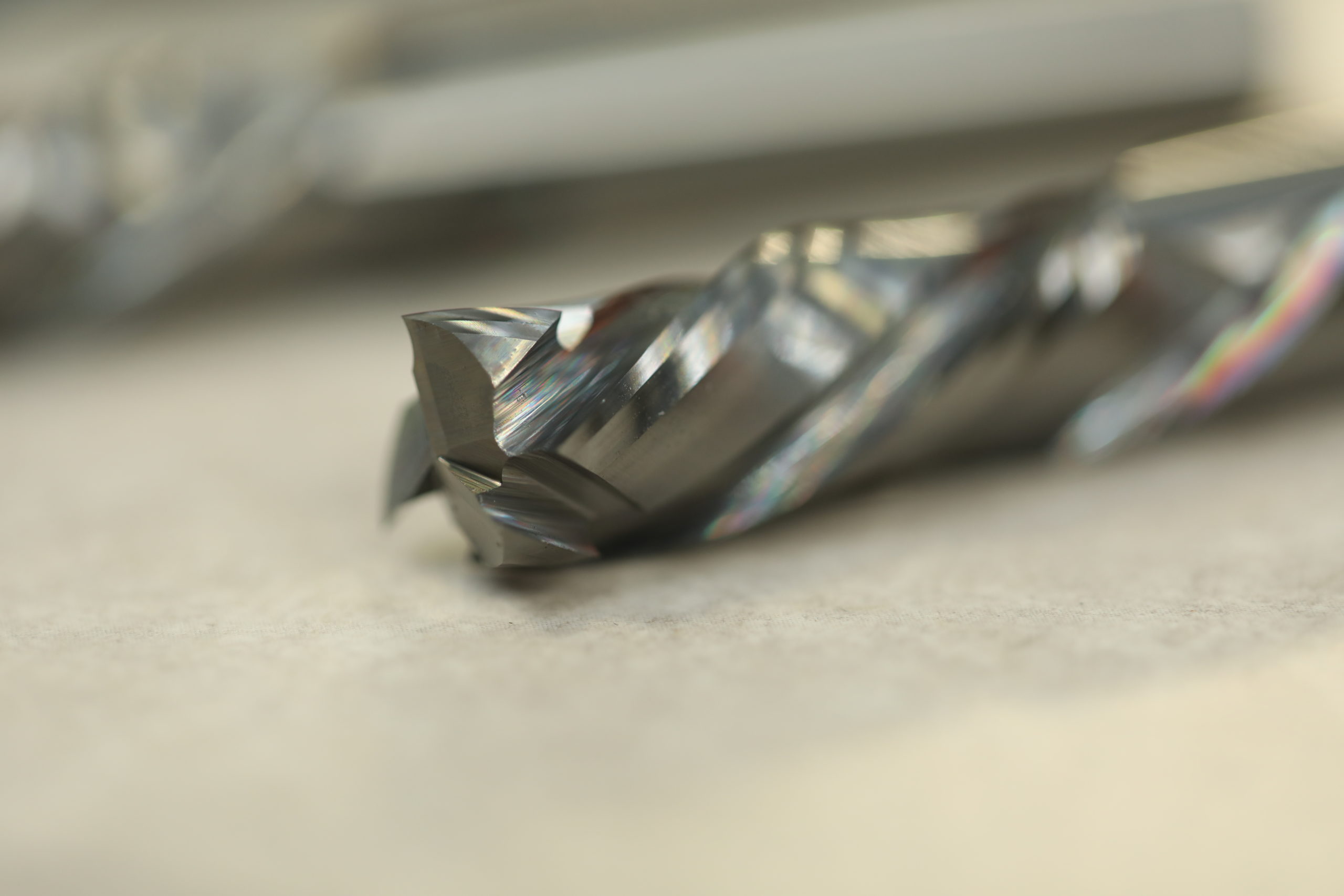

In the Australian wood processing industry there is significant demand for compression routers (tools with opposing cutting flutes) also known as compound shear or up-down cutters. As the demand for this product increased, Leitz Australia needed to protect their position against fierce competition of compression router supply.

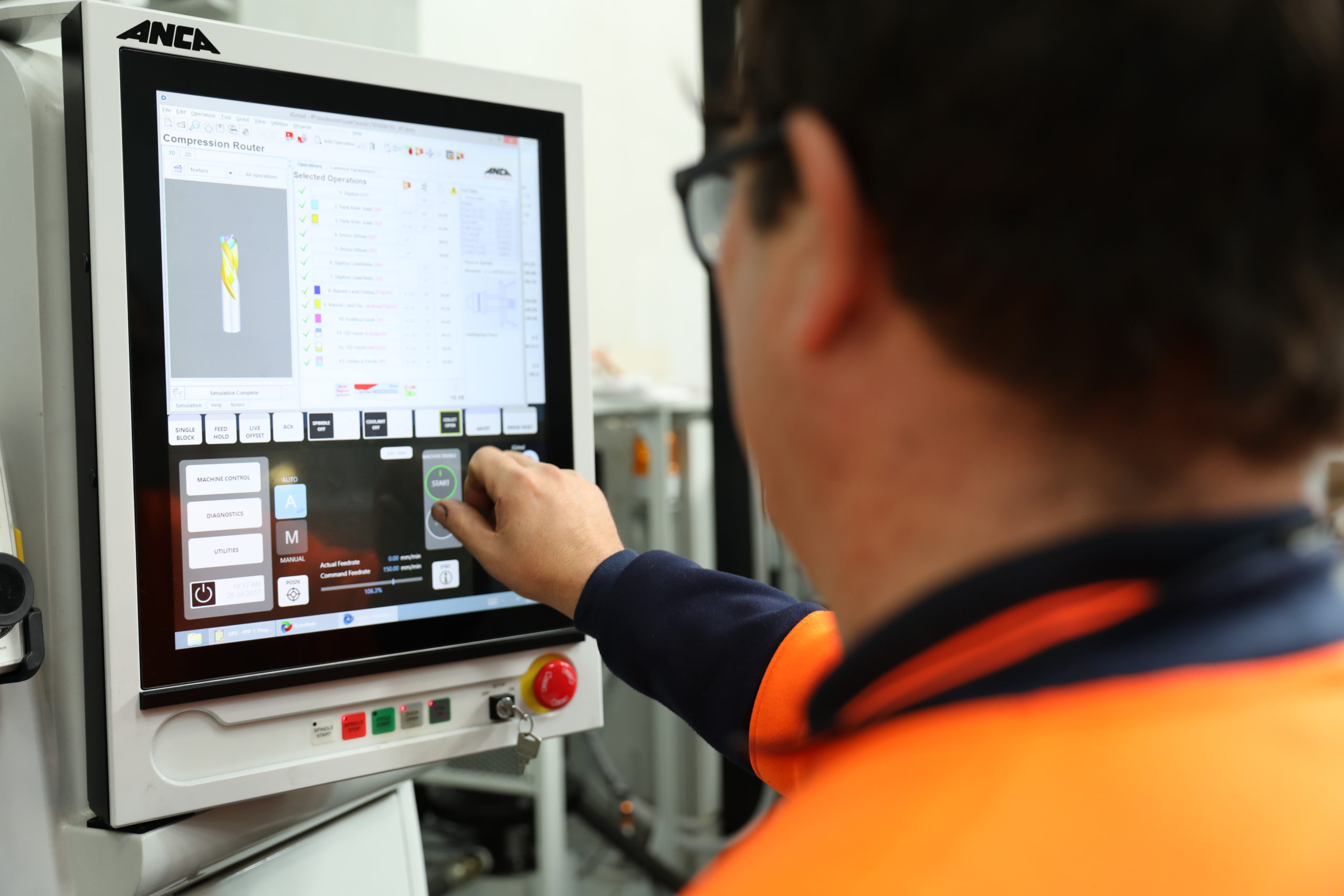

In 2016 the FX7 Linear CNC grinding machine was installed and was configured with the high capacity Fanuc robot loader, ANCA Motions cylindrical LinX linear motor (patented by ANCA), full size touchscreen at 19” and a handheld pendant for simplified setups.
Joel continued, “after three days of basic operator training, the machine was operating at full production capacity. Since the FX7 was installed it has produced almost 10,000 tools so we have been thrilled with the machine uptime.”
“The flexible software and time savings was another important feature. Using the 3DCimulation software on our offline PC means we can verify the next tool type to be produced, while the machine is in use grinding tools.”
“The 3DCim software can check and calculate all aspects of the tool, including dimensions, geometry, profiles, etc. which is critical when measuring items such as core diameter prior to grinding to avoid any production problems. The software saves time on tool design, reduces grinding setup time and ensures accurate tools are ground first time at the start of grinding a batch of tools, resulting in actual cost savings”.
“One of the advantages of the FX7 is the reduction in delivery times. The machine has a robot loader for fast production of special tools in large quantities that can now be delivered within days. Furthermore, it has a capacity to manufacture up to 320 pieces for Ø8mm routers (maximum of 840 pieces for Ø3mm) and the loader has four times the capacity of the machine we previously used to produce compression routers. “
“Not all production runs need to be in large quantities. The machine can do multiple tool types of the same diameter size in the one pallet. Small batches of 5-10 tools of 30 different tool types could be done in the one production setup”.
