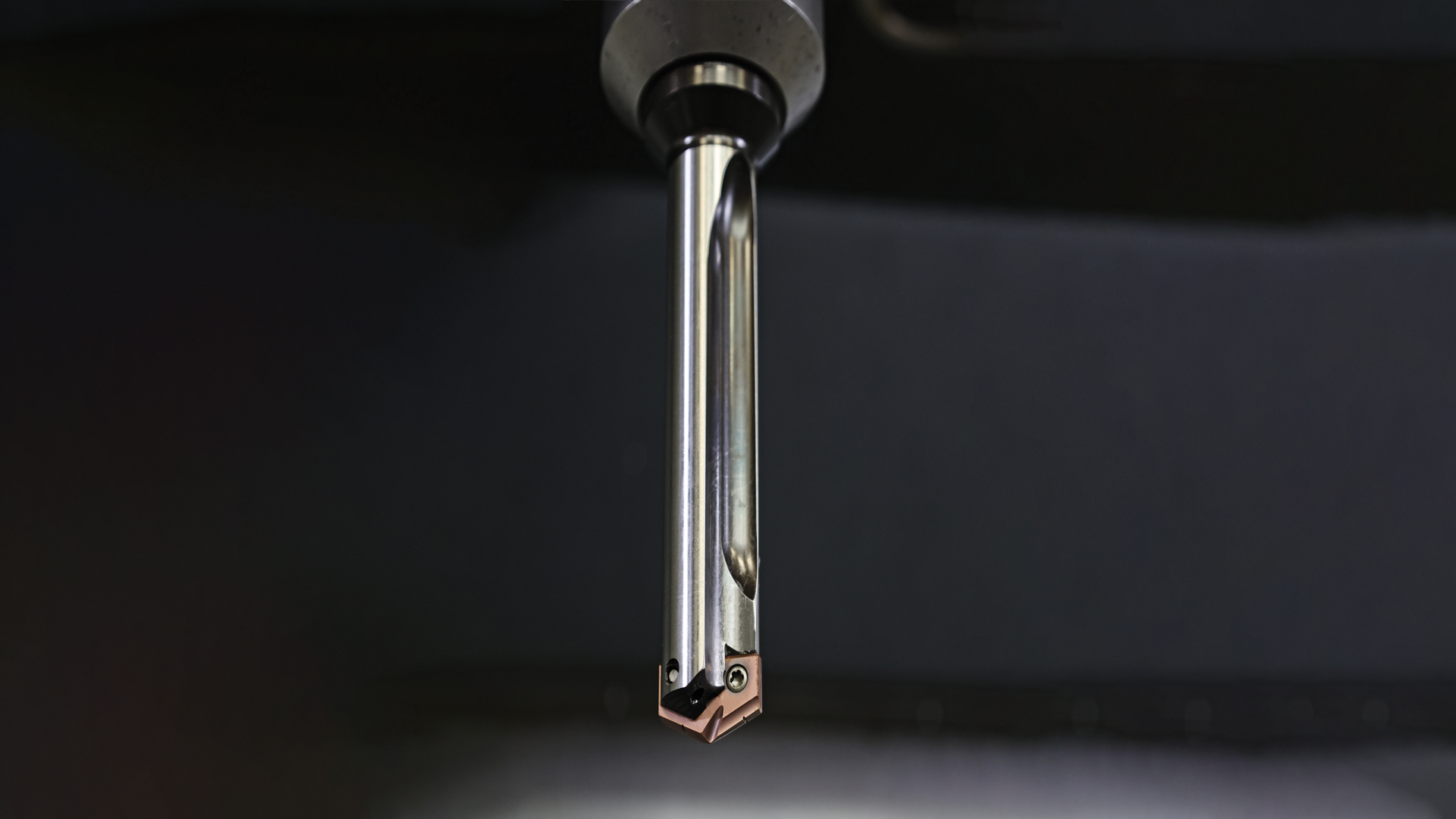

Kingswinford, UK: Allied Machine and Engineering, a leading manufacturer of holemaking and finishing tools for the metal-cutting industry, announces the launch of the T-A Pro M geometry insert. As the newest expansion of the T-A Pro high-penetration drilling system, this insert targets stainless steel and heat resistant super alloy (HRSA) materials. With the release of the ISO-material class M geometry and proprietary margin design paired with the development of the new AM460 coating, Allied Machine is able to provide a tool that offers low cutting forces, excellent penetration rates and long tool life in challenging stainless and heat resistant super alloys. The new insert geometry produces the best results with the newly designed T-A Pro holders but is also compatible with T-A holders and is offered in Z-3 series with diameters ranging from 11.10 millimeters – 47.80 millimeters.
