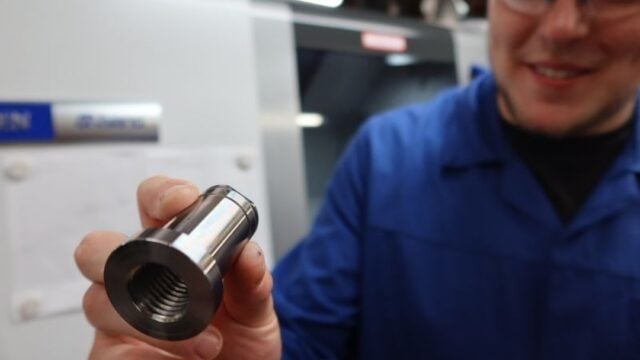

ABL’s senior production controller Dave Stacey advised, “Take the collet, for example, produced from 13 mm diameter tool steel bar. The concentricity of the front bore to the taper is tied up to 30 microns TIR (total indicator reading).
“Dimensional tolerances on diameter and length need to be within 50 microns or sometimes 25 microns to allow post machining to sub-micron accuracy, while there is a 6-micron limit in the bore.
“Originally, before our decision to use subcontract services, these collets were machined in-house in two operations – turning and boring on a fixed-head lathe and then drilling of eight radial holes on a machining centre.
“The time-consuming process led to our pre-finishing department only producing the quantity that was needed, which could be as low as 15-off, yet external heat treatment and stress relieving before final finishing still cost £250 a time, irrespective of component quantity.
“Now, with single-hit turn-milling of the collets on the Cincom L20, we run off typically 500, representing three months’ supply, at a fraction of the cost of subcontracting them out, added to which we can take full advantage of the fixed-cost heat treatment service.”
