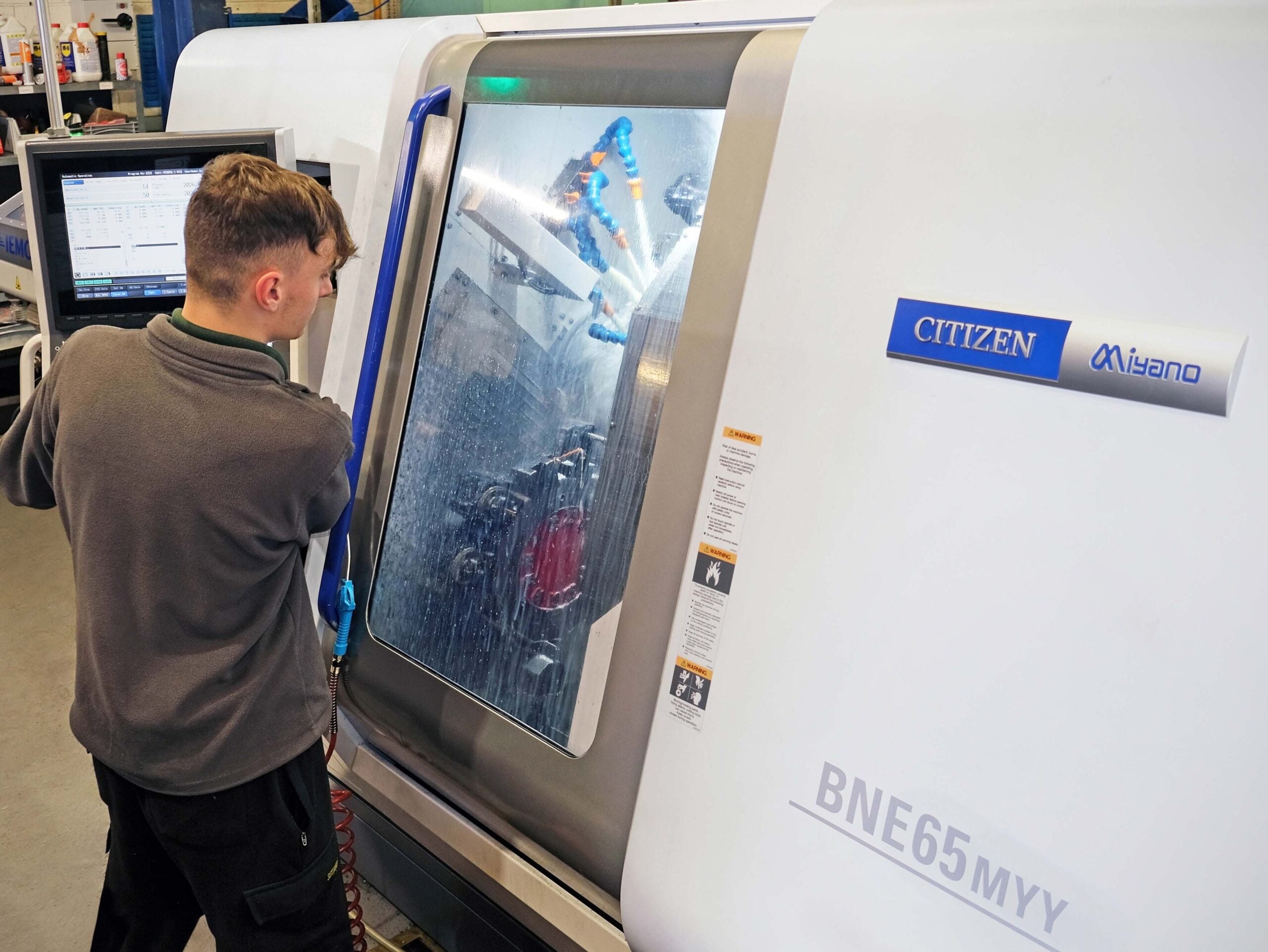

In the intervening 20 years, a lot has changed at the Keighley, West Yorkshire factory, which is now run by Michael and Lynda’s sons Sam and Jack, both time-served engineers like their father. In November 2024, they bought a modern, larger Miyano of 65 mm bar capacity, a BNE-65MYY. Despite another six fixed-head lathes of various makes arriving on the shop floor over the years, the latest machine is the undoubted favourite of the second-generation directors.
Managing director Sam Laybourne commented, “Parts come off the BNE twice as quickly as one of our BNJs can produce them, greatly increasing productivity, and the two Y-axis turrets mean that components of higher complexity can be finished in one hit.
“The new Miyano is not only faster due to uprated feeds and speeds, but is also more rigidly and accurately built, and more thermally stable than other lathes on the shop floor. It translates into higher quality parts and less tool wear and breakages.”
He explained that a key feature of the BNE is its box sideways that are hand scraped to near-perfect smoothness and flatness. The process removes high spots on the hardened steel surface, lowering noise, virtually eliminating vibration and chatter, prolonging tool life and improving the surface finish on machined components.
Furthermore, box ways rather than linear guideways provide better rigidity for selecting higher cutting data when turning and especially when milling. It contributes substantially to the machine’s productivity, particularly as prismatic machining frequently accounts for between 20% and 50% of a cutting cycle in the Keighley factory.

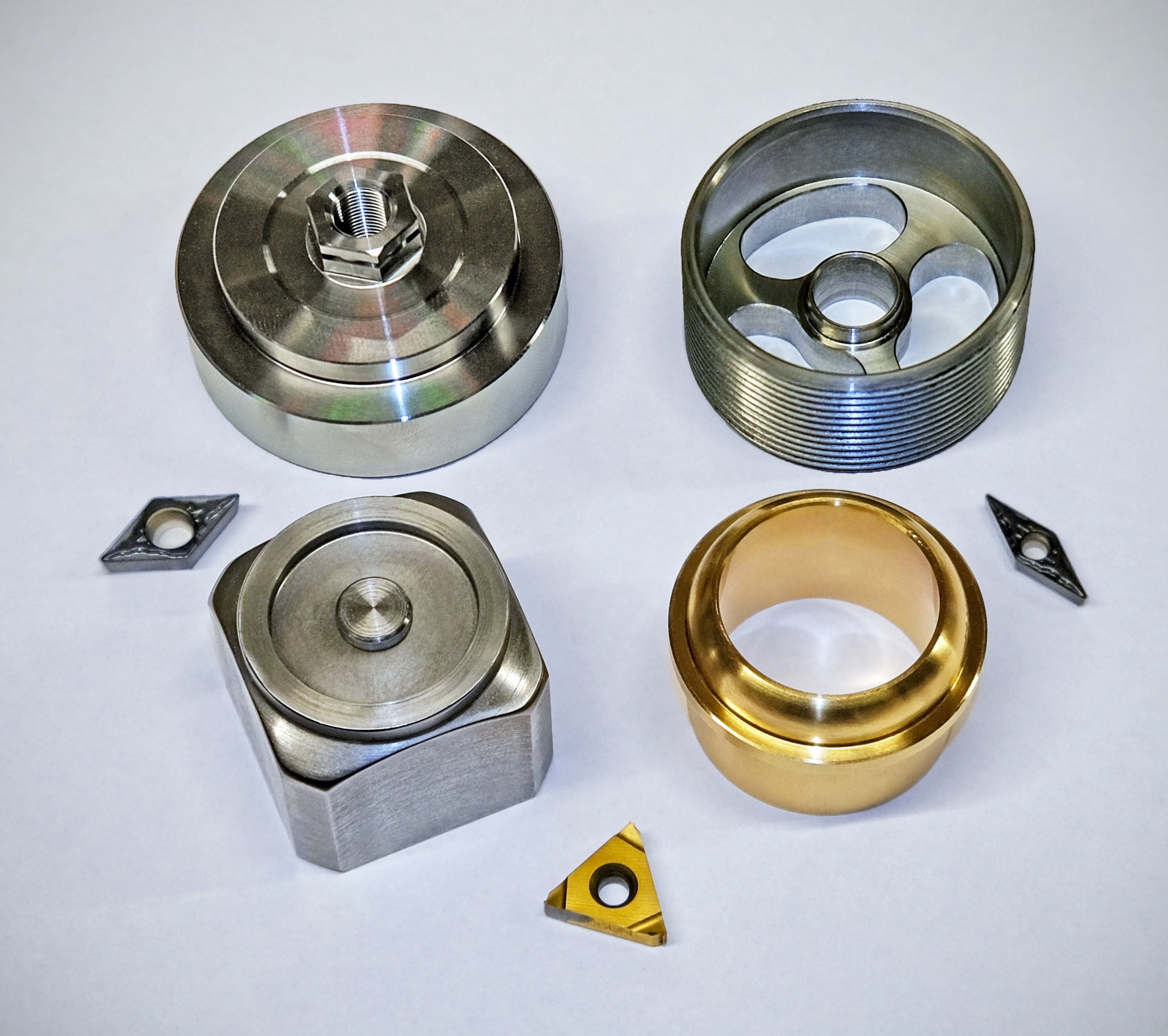

There are many attributes of the latest Miyano that both brothers appreciate. One is its stability, both mechanically and thermally, which results in effortlessly holding tolerances down to ± 10 microns, although ± 0.1 mm is more generally stipulated on customers’ drawings. A wide range of materials is processed, from Duplex and Inconel through to engineering plastics.

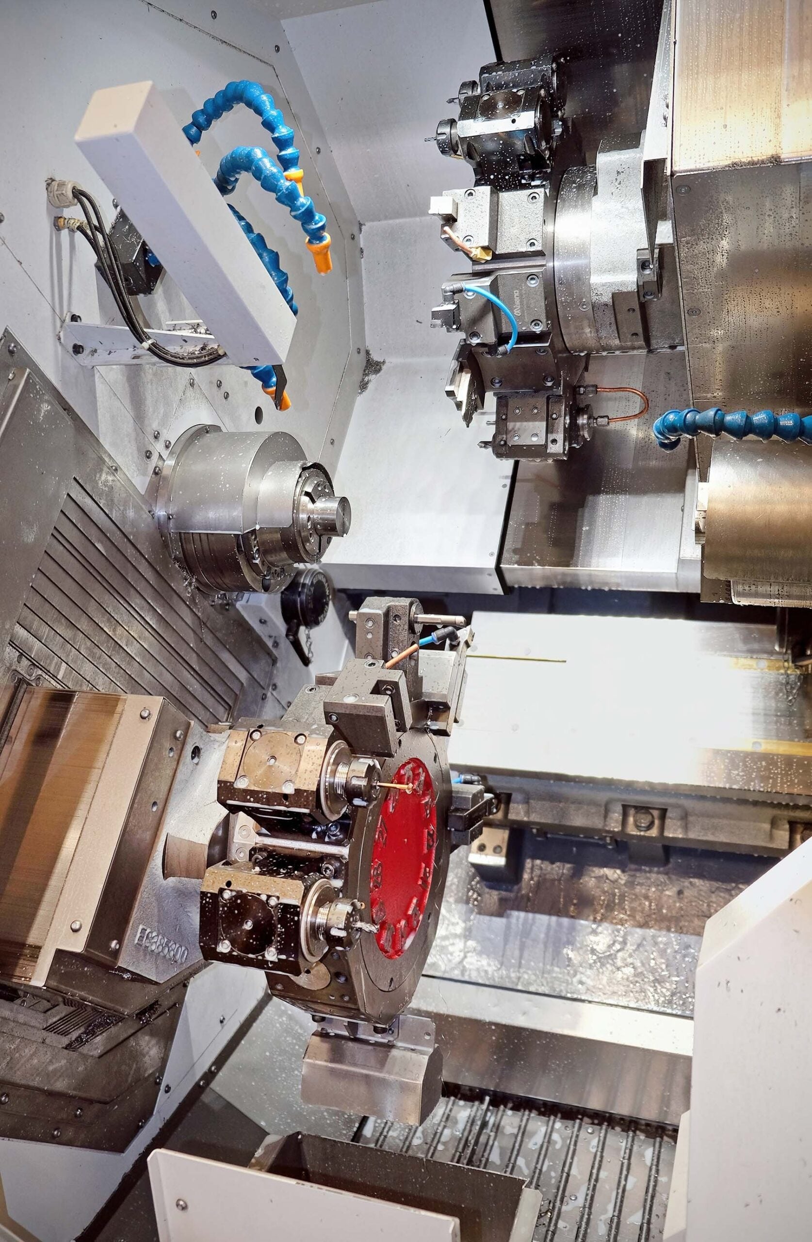

Not only is the machine typically twice as productive as the early Miyano models, but there is scope for even shorter cycles using the BNE’s superimposed machining capability, where three tools can be cutting a part simultaneously at both spindles, despite the lathe having two turrets. This facility has not yet been adopted in Keighley, but will be in the future for the right jobs, namely reasonably long runs of parts with complex features, where the somewhat longer setup times can be justified.
YPEL staff was comprehensively trained by Citizen to program, set and operate the latest Miyano. The subcontractor opted to buy the relevant edition of Citizen’s Alkart Wizard conversational programming software, which bridges the gap between manual G-code data entry and full-scale CAD/CAM. It is particularly effective for generating cycles for complex, multi-path machining, including all necessary synchronisation codes to prevent the spindles and turrets from colliding, while also managing the hand-off of parts between the main and sub spindle. As an added bonus, the software helps with programming the older BNJs.
The beneficiaries of these technology advances are YPEL’s many customers, about 40% of which are in the oil and gas sector, with a further 20% operating in the medical industry. That the subcontractor has held ISO 9001 accreditation since the company started has led to a lot of work in many other sectors as well, including agriculture, electronics, marine and pharmaceuticals. Music enthusiasts may be interested that parts for bagpipes and grand pianos are occasionally machined; and pub-goers may well be staring at YPEL parts as their pints are pulled.
