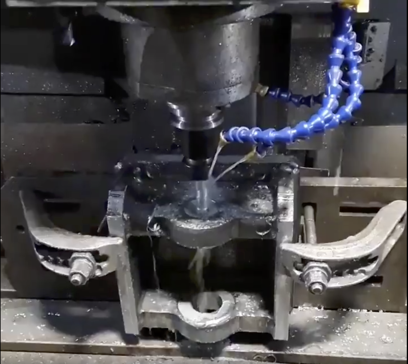

Another nice little part from Bedford CNC. A pivot bracket made from mild steel (S275JR) and part of a welded fabrication.
Cutting at this rate;
– Speed of 4,000rpm and a
– Feed of 3,000mm/min and
– 0.8mm depth of cut
This DoFeed cutter was ploughing through the work
