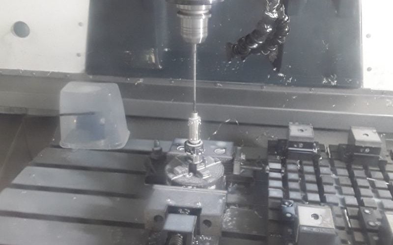

Crazy Set Up?
Tuesday 3 August 2021, 11:00:09 AM
Ok, it’s not the best setup, but needs must for a sample part. Drilling 316 stainless = 4.5mm dia 1 x 138mm deep. 3540rpm feed = 0.1mm rev. Oh, Andy had his hand over the big red button but it wasn’t needed as the cmx800v just blew the swarf away. Happy days!
