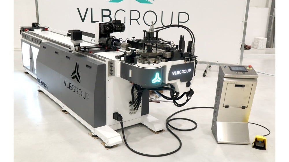

The ECO-NC CNC tube bending machine series is easy to operate, robustly constructed and achieves excellent bending results. Entering a new bending program is very intuitive with the help of an industrial touch controller and the accurate and user-friendly VLB 2D software. The NC program precisely controls the bend angle (Y-axis) and rotation (Z-axis). The distance between the bends (X-axis) is configured using easily adjustable and very precise mechanical stops.
The essential movements – bending angle and rotation of the pipe – are fully electric to ensure exact repeatability. The supporting bending movements are driven by a powerful hydraulic group. All movements are electronically controlled. These properties make the ECO-NC CNC tube bending machine series very versatile and suitable for high-quality bending work, in small and medium-sized series.
EB ECO-NC CNC tube bending machine series features:
  • Simple, durable functionality with excellent bending results.
  • Very intuitive programming of pipe bending angle and rotation with industrial touch controller.
  • Drive of bending and rotation of the tube partly electrically.
  • Supporting hydraulic drive.

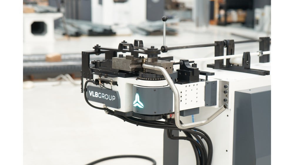

  • Quick change of pipe bending tool, with easy adjustment possibility.
  • Revolutionary clamping system, with a compact bending head.
  • Powerful and low-maintenance bending machine with a reduced bending head increases the possibilities of complex bending work.
  • Integrated tool cabinet with interior lighting.
  • Compact and ergonomic design takes up little production space and improves operating and maintaining comfort.
