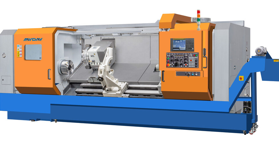

TURNING CENTER – TD12 & TD12C
Thursday 27 March 2025
Supplier Information
Detailed Specification
MYDAY MODELTD12TD12C
SWING OVER BED  Unit mm690
OVER CROSS SLIDE    mm480
MAX. TURNING DIA.    mm510440
MAX.WORK LENGTH    mm750/1000/1500/2000/3000
700/945/1445/1945/2990(MC)
CHUCK SIZE  inch12″
DRAW TUBE DIA.  mmø91
SPINDLE SPEED RANGE RPM3200
SPINDLE NOSE    ASAA2-8
SPINDLE BORE  mmø102
FRONT BEARING DIA. mmø140
SPINDLE TAPPER1/20
MILLING SPEED    RPM5000
X-AXIS TRAVEL mm295285
Z-AXIS TRAVEL mm760/1020/1520/2020/3020
ControllerFANUC 0i-TF3 / SIEMENS 828D
Spindle Motor18.5 Kw / 17 Kw
X-AXIS RAPD TRAVERS m/min20m/min
Z-AXIS RAPD TRAVERSRSE m/min20m/min
GUIDEWAY TYPEBox way/30∘
NUMBERS OF TOOL STATION12T12T
O.D. TOOL     mm□25□32
BORING BAR DIA.    mmø40/ø50(opt)ø40
QUILL DIA.    mmø100(opt : ø130)
QUILL TRAVEL    mm120
TAILSTOCK TRAVEL    mm600/850/1350/1850/2850
QUILL TAPERMT#5
POWER SUPPLY    kva50
60(≧3000)
COOLANT TANK CAPACITY    Liter150
COOLANT FLOW    L/mm30
MACHINE HEIGHT    mm(H)2000/2350(3M)
FLOOR SPACE    mm(L)3300/3900/4400/4900/6400
FLOOR SPACE    mm(L)2248
NET WEIGHT    kg7400/7900/8400/9000/9500
