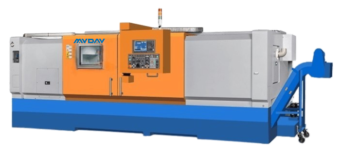

TURNING CENTER – TC12 & TC12C
Thursday 27 March 2025
Supplier Information
Detailed Specification
MYDAY MODELTC12TC12C
SWING OVER BED  Unit mm600
OVER CROSS SLIDE    mm400
MAX. TURNING DIA.    mm450330
MAX.WORK LENGTH    mm480/730/990/1500/2000
450/700/960/1500/2000(MC)
CHUCK SIZE  inch12″
DRAW TUBE DIA.  mmø91
SPINDLE SPEED RANGE RPM3200
SPINDLE NOSE    ASAA2-8
SPINDLE BORE  mmø102
FRONT BEARING DIA. mmø140
SPINDLE TAPPER1/20
MILLING SPEED    RPM5000
X-AXIS TRAVEL mm245245
Z-AXIS TRAVEL mm500/750/1010/1590/2090
ControllerFANUC 0i-TF3 / SIEMENS 828D
Spindle Motor18.5 Kw / 17 Kw
X-AXIS RAPD TRAVERS m/min20m/min
Z-AXIS RAPD TRAVERSRSE m/min20m/min
GUIDEWAY TYPEBox way/30∘
NUMBERS OF TOOL STATION12T12T
O.D. TOOL     mm□25□25
BORING BAR DIA.    mmø40
QUILL DIA.    mmø90(opt:ø110)
QUILL TRAVEL    mm120
TAILSTOCK TRAVEL    mm400/650/920/1480/1980
QUILL TAPERMT#5
POWER SUPPLY    kva40
COOLANT TANK CAPACITY    Liter150
COOLANT FLOW    L/mm30
MACHINE HEIGHT    mm(H)1905
FLOOR SPACE    mm(L)2900/3300/3700/4350/4950
FLOOR SPACE    mm(W)2100
NET WEIGHT    kg5100/5500/6000/6500/7100
