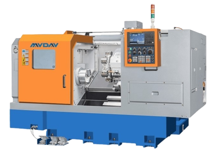

Detailed Specification
| MYDAY MODEL | TC10 | TC10C | |
| SWING OVER BED Unit mm | 600 | ||
| OVER CROSS SLIDE mm | 400 | ||
| MAX. TURNING DIA. mm | 450 | 330 | |
| MAX.WORK LENGTH mm | 500/750/1000/1500/2000 470/720/970/1500/2000(MC) | ||
| CHUCK SIZE inch | 10″ | ||
| DRAW TUBE DIA. mm | ø75 | ||
| SPINDLE SPEED RANGE RPM | 4200 | ||
| SPINDLE NOSE ASA | A2-8 | ||
| SPINDLE BORE mm | ø92 | ||
| FRONT BEARING DIA. mm | ø130 | ||
| SPINDLE TAPPER | 1/20 | ||
| MILLING SPEED RPM | – | 5000 | |
| X-AXIS TRAVEL mm | 245 | 245 | |
| Z-AXIS TRAVEL mm | 500/750/1010/1590/2090 | ||
| Controller | FANUC 0i-TF3 / SIEMENS 828D | ||
| Spindle Motor | 18.5 Kw / 17 Kw | ||
| X-AXIS RAPD TRAVERS m/min | 20m/min | ||
| Z-AXIS RAPD TRAVERSRSE m/min | 20m/min | ||
| GUIDEWAY TYPE | Box way/30∘ | ||
| NUMBERS OF TOOL STATION | 12T | 12T | |
| O.D. TOOL mm | □25 | □25 | |
| BORING BAR DIA. mm | ø40 | ||
| QUILL DIA. mm | ø90(opt:ø110) | ||
| QUILL TRAVEL mm | 120 | ||
| TAILSTOCK TRAVEL mm | 400/650/920/1480/1980 | ||
| QUILL TAPER | MT#5 | ||
| POWER SUPPLY kva | 30 | ||
| COOLANT TANK CAPACITY Liter | 150 | ||
| COOLANT FLOW L/mm | 30 | ||
| MACHINE HEIGHT mm(H) | 1905 | ||
| FLOOR SPACE mm(L) | 2900/3300/3700/4350/4950 | ||
| FLOOR SPACE mm(W) | 2100 | ||
| NET WEIGHT kg | 5100/5500/6000/6500/7100 | ||
