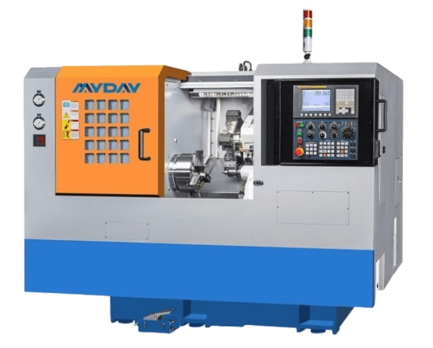

TURNING CENTER – TB10 & TB10C
Thursday 27 March 2025
Supplier Information
Detailed Specification
MYDAY MODELTB10TB10C
SWING OVER BED  Unit mm545
OVER CROSS SLIDE    mm350
MAX. TURNING DIA.    mm380250
MAX.WORK LENGTH    mm500/750/1000
CHUCK SIZE  inch10″
DRAW TUBE DIA.  mmø75
SPINDLE SPEED RANGE RPM4200
SPINDLE NOSE    ASAA2-8
SPINDLE BORE  mmø92
FRONT BEARING DIA. mmø130
SPINDLE TAPPER1/20
MILLING SPEED    RPM6000
X-AXIS TRAVEL mm200200
Z-AXIS TRAVEL mm530/780/1030
ControllerFANUC 0i-TF3 / SIEMENS 828D
Spindle Motor11 Kw
X-AXIS RAPD TRAVERS m/min20m/min
Z-AXIS RAPD TRAVERSRSE m/min20m/min
GUIDEWAY TYPEBox way/30∘
NUMBERS OF TOOL STATION10T12T
O.D. TOOL     mm□25□20
BORING BAR DIA.    mmø40ø32
QUILL DIA.    mmø90
QUILL TRAVEL    mm85
TAILSTOCK TRAVEL    mm460/710/960
QUILL TAPERMT#5
POWER SUPPLY    kva30
COOLANT TANK CAPACITY    Liter125
COOLANT FLOW    L/mm30
MACHINE HEIGHT    mm(H)1700
FLOOR SPACE    mm(L)2300/3100/3900
FLOOR SPACE    mm(W)1500
NET WEIGHT    kg4300/4900/5500
