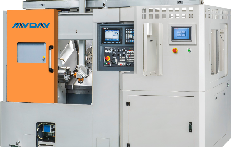

TURNING CENTER – TA8 & TA8C
Thursday 27 March 2025
Supplier Information
Detailed Specification
MYDAY MODELTA8TA8C
SWING OVER BED  Unit mm505
OVER CROSS SLIDE    mm345
MAX. TURNING DIA.    mm380250
MAX.WORK LENGTH    mm270228
CHUCK SIZE  inch8″
DRAW TUBE DIA.  mmø52
SPINDLE SPEED RANGE RPM4500
SPINDLE NOSE    ASAA2-6
SPINDLE BORE  mmø62
FRONT BEARING DIA. mmø100
SPINDLE TAPPER1/20
MILLING SPEED    RPM6000
X-AXIS TRAVEL mm225225
Z-AXIS TRAVEL mm290
ControllerFANUC 0i-TF3 / SIEMENS 828D
Spindle Motor11 Kw
X-AXIS RAPD TRAVERS    m/min15m/min
Z-AXIS RAPD TRAVERSRSE    m/min18m/min
GUIDEWAY TYPEBox way/30∘
NUMBERS OF TOOL STATION10T12T
O.D. TOOL     mm□25□20
BORING BAR DIA.    mmø40ø32
QUILL DIA.    mmø58
QUILL TRAVEL    mm88
TAILSTOCK TRAVEL    mm190
QUILL TAPERMT#4
POWER SUPPLY    kva2125
COOLANT TANK CAPACITY    Liter110
COOLANT FLOW    L/mm60
MACHINE HEIGHT    mm(H)1930/3264(A)
FLOOR SPACE    mm(L)1626/2593(A)
FLOOR SPACE    mm(W)1487/1700(A)
NET WEIGHT    kg3350/3510(A)
