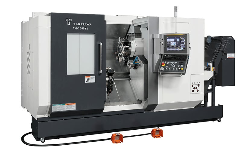

Takisawa Japan TM-3000Y2
Wednesday 8 May 2024
Supplier Information
Detailed Specification
Slant Bed, Y-Axis CNC Lathe with Twin Spindle & Twin Turrets
High Performance CNC Multitasking Lathe with Upper & Lower Y-Axes Specialized for Bar Machining. 8 Inch + 6 Inch Standard Chuck Size
Standard Turning Diameter – 215 MM
Maximum Turning Diameter – 215 MM
Maximum Turning Length – 620 MM
Bar Capacity (Left Spindle) – 65 MM
Bar Capacity (Right Spindle) – 42 MM
Upper Turret Travel (X1) – 190 / 90 MM
Upper Turret Travel (Y1) – 90 (± 45) MM
Upper Turret Travel (Z1) – 660 MM
Lower Turret Travel (X2) – 190 / 90 MM
Lower Turret Travel (Y2) – 90 (± 45) MM
Lower Turret Travel (Z2) – 660 MM
Travel A (RH Spindle) – 660 MM
LEFT SPINDLE
Chuck Size – 8” / 203 MM
Spindle Speed – 4,500 RPM
Min. Indexing Angle (C-Axis) – 0.001 DEG
Spindle Nose – A2-6
Spindle Bore – 77 MM
Inner Bearing Diameter – 110 MM
RIGHT SPINDLE
Chuck Size – 6” / 152 MM
Spindle Speed – 6,000 RPM
Spindle Nose – A2-5
Spindle Bore – 53 MM
Inner Bearing Diameter – 90 MM
Number of Tools (Upper & Lower) – 12
FANUC 0iTF PLUS CNC
