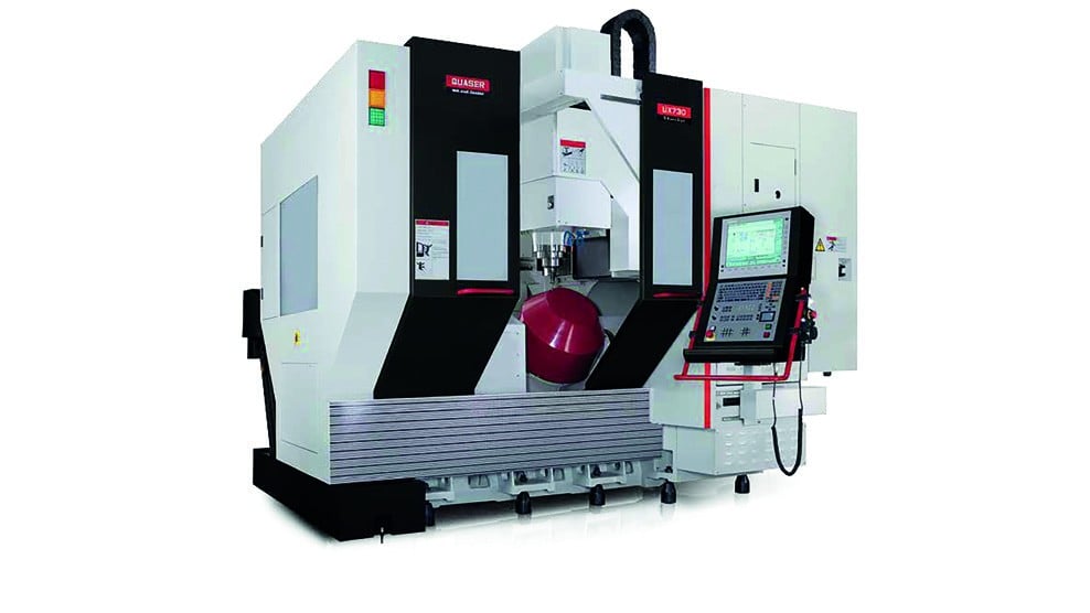

UX 600 by quaser
UX600
  • Equipped with proven mechanical swiveling rotary
  • Table for working capacity up to
  • Ø630 x 425 mm / 300 kg (Economic Version)
  • Ø600 x 430 mm / 300 kg
  • Ø640 x 440 mm / 500 kg
  • Modular structure designed on UX600, UX730Dyn
  • All models use the same base, column, cross slider & ATC unit.
  • Major difference are spindle head & A/C axes table.
UX730
  • Equipped with state-of-art torque motor
  • On swiveling & rotary axes
  • Ø730 x 475 mm / 850 kg
