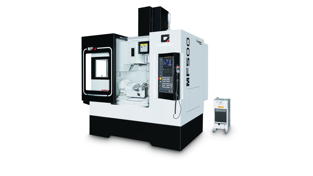

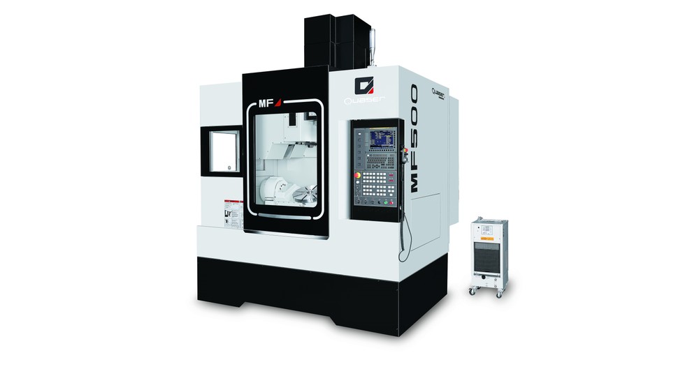

MF500 by quaser
High Speed Vertical Machining Centre
The MF series of 5 axis and 5 face machining centres from Quaser deliver powerful and accurate CNC high-speed vertical machining and are renowned for their state-of-the-art technology.
- Table size: 410mm diameter
- Travel X / Y / Z: 550 / 630 / 610mm
- ATC capacity: 30 (std) 48, 60, 120 options
- Workpiece size: Ø500 x 300mm
- Total load capacity: 300kg
- Unique spindle technology

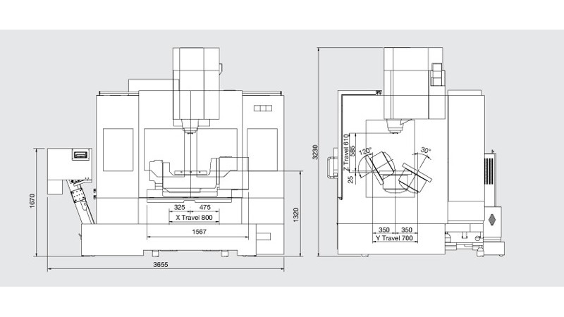

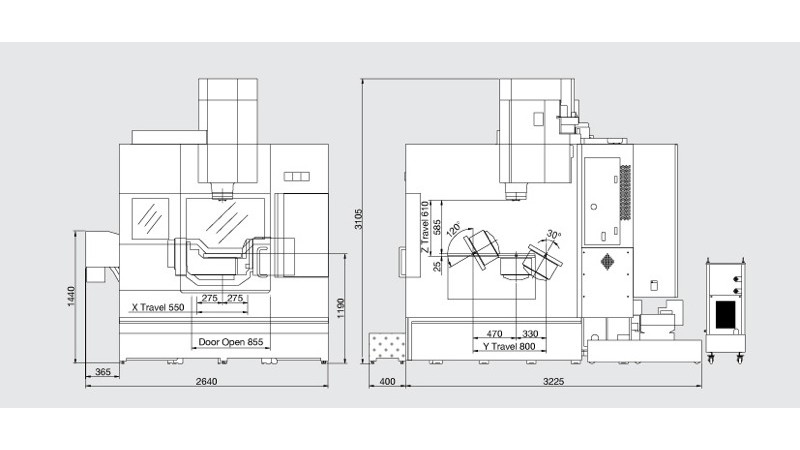

Technology information
WORK RANGE |

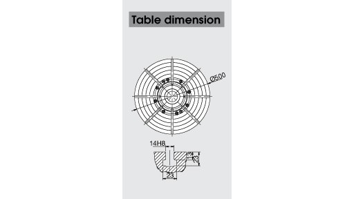

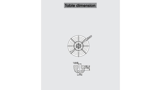

Table size (mm) |
Φ410 |
Max. swing (mm) |
Φ500 |
Max. work piece size (mm) |
Φ500 x 300 |
Travel X (mm) |
550 |
Travel Y (mm) |
630 |
Travel Z (mm) |
610 |
Table load capacity (kg) |
300 |
MAIN SPINDLE |
Spindle taper |
BBT 40 taper |
Max. spindle speed |
12,000 (std), 15,000, 18,000, 20,000, 24,000 (opt) |
TOOL CHANGER |
Magazine positions |
30 (std.) 48 / 60 / 120 (opt.) |
Max. tool diameter (mm) |
76.2 |
Max. tool dia. with adjacent pots empty (mm) |
125 |
Max. tool length (mm) |
280 |
