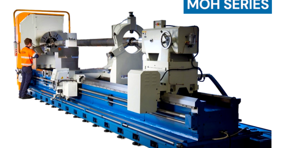

Oil Country Lathe is a famous product line for oil & gas fielding and metal industry. It could be big bore lathe of double chucks at both sides of the headstock, or it could have large swing for big workpiece. Big bore lathe is very good at threading and cutting at the two ends of long pipes or tubes. Besides, large swing could be applied to big steel rollers, large diameter flanges, long shafts of ships, etc. By the way, for better workpiece clamping, we have rotary quill option on tailstocks.
Description \ ModelMOH1200MOH1400MOH1600
Center height600 mm700 mm800 mm
Swing over bed1190 mm (47”)1385 mm (55”)1580 mm (63”)
Swing over cross slide830 mm1030 mm1230 mm
Swing over gap1750 mm1950 mm2150 mm
Width of gap600 mm
(No gap if Distance between centers ≥ 5m)
Width of bed800mm (32”) (1000mm with auxiliary guideway)
Distance between centers 2000~15000 mm (80~600”) In one piece
Spindle boreØ156mm (6”)/ Ø230mm (9”)/ Ø260mm (10”)/ Ø310mm (12”)/ Ø360mm (14”) / Ø535mm (21”)
Spindle noseA2-15 / A2-15 / A2-15 / A2-20 / A2-20 / A2-28
Spindle speeds (12 Steps)9-550 / 6-400 / 6-400 / 5-300 / 5-300 / 3-230 rpm
Tailstock quill diameterØ200 mm (Std.) or Ø290 mm Rotary Quill (Opt.)
Taper of centerMT#7
Quill travel300 mm
Cross feeds0.065-0.96 (48 Kinds)
Cross travel 780 mm
Compound rest travel350 mm
Tool size50 x 50 mm
Longitudinal feeds0.13-1.92 (48 Kinds)
Lead screw diameterØ50mm
Lead screw pitch2TPI (inch) or 12mm (metric)
Threading range, metric2-30 mm/Pitch (48 Kinds)
Threading range, inch1-15 TPI (48 Kinds)
Module pitch threads1-15M (32 Kinds)
DP. pitch threads2-30P (48 Kinds)
Main spindle motor30 HP (Std.), 40HP (Opt.) or 50HP (Opt.)
Rapid motor1 HP
Coolant pump1/4 HP
Oil pump 12W
