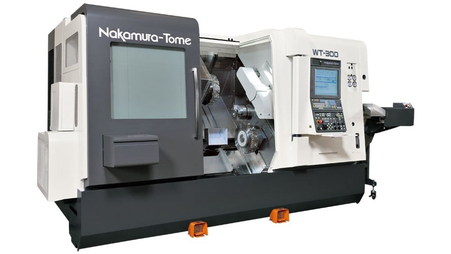

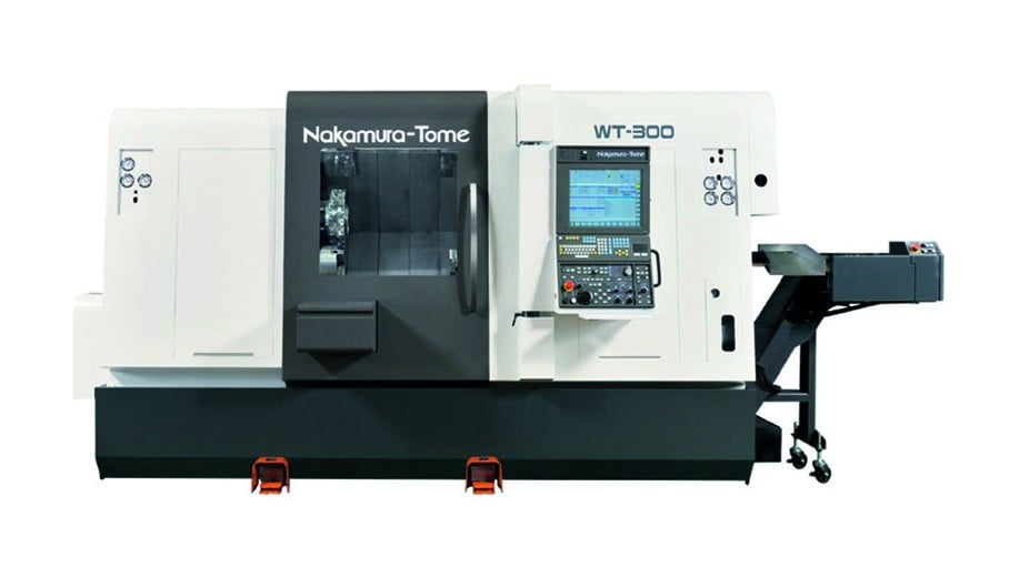

WT-300 by nakamura-tome
High rigidity multi-tasking machine with box-type slides for all axis.
  • Up to 30kW cutting power available for turning shaft-work with synchronized spindles.(Motor power 15/11kW per spindle)
  • Driven-Tool Motor Power 5.5/3.7kW,for heavy cutting with small tools.

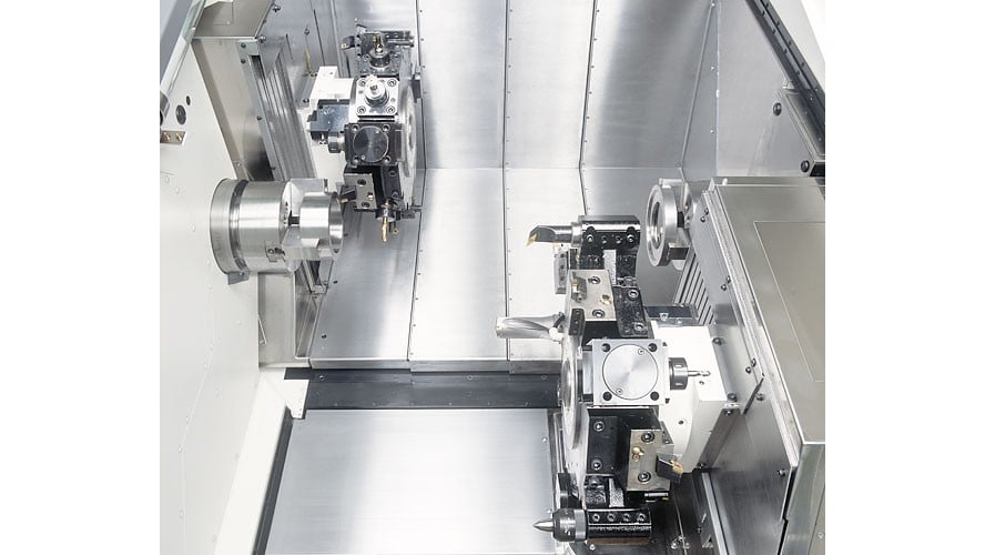

  • With upper / lower turret construction,4-axis machining as well as various other machining combinations possible on either spindle
  • With upper / lower turrets and opposed two-spindle construction,cycle time balancing and reduction is possible.
  • With up to 24-tools per turret,48 tools can be permanently available.
