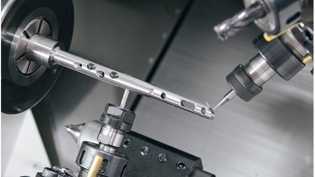

The Nakamura Super NTJ is equipped with built-in twin spindles. It has a swivelling B-Axis Turret, with a swivelling range of 182° and a tool capacity of up to 48 tools.
In addition to angular drilling and end milling, arbitrary contour-milling can be performed with standard driven-tool holders on the Super NTJ. The Super NTJ has ultimate flexibility with the upper turret having a B-axis, having a swivelling range of 182° and up to 48 tools. Furthermore, simultaneous cutting with upper and lower tools on L/R opposed-spindles ensures balanced processes and faster cycle times.
