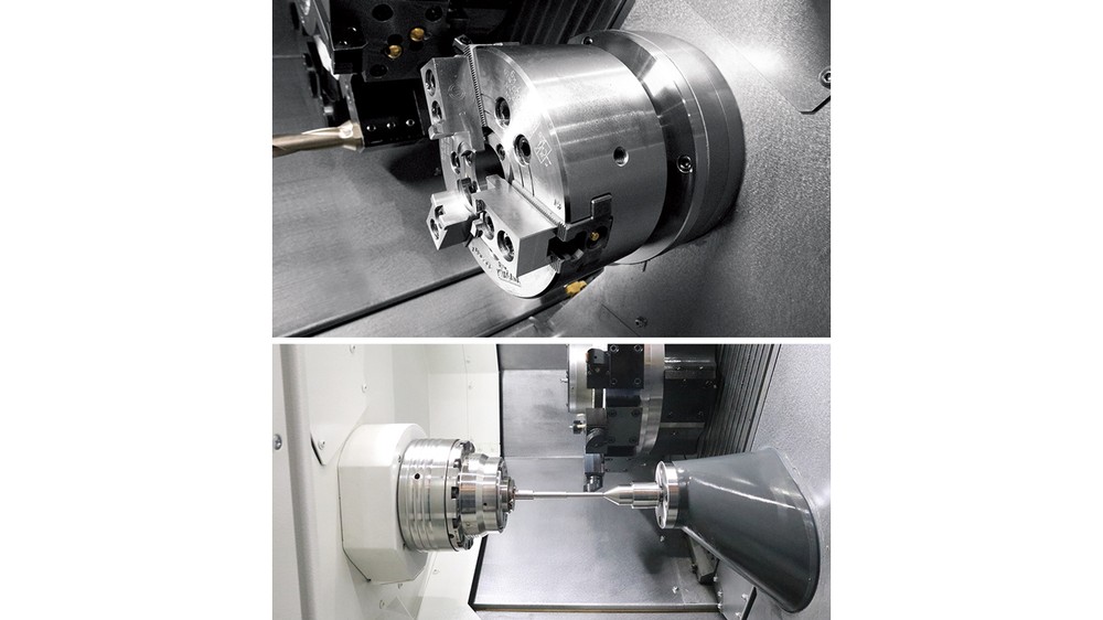

The Nakamura SC-100 is a compact single turret machine with high rigidity.
 It features a Parts Catcher with integrated parts conveyor as standard for sub-spindle specification. The SC-100 has a Z-axis travel of 400mm and is capable of 100% recovery of lubrication oil (standard specification/theoretical value). This machine is environment-friendly having an inverter-type hydraulic unit.
Simple, but goes beyond expectations
  • Milling and Y-Axis are Standard
  • Y-axis Stroke 80mm (±40mm)
  • Compact footprint: 2,523.6mm×1,825mm (standard specification)
  • 7.1/2.2kW milling motor, max spindle speed 6,000min-1.
  • 7.5/5.5kW sub spindle (op.).
