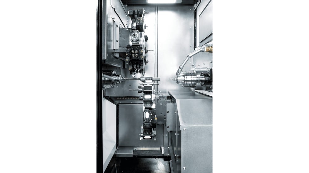

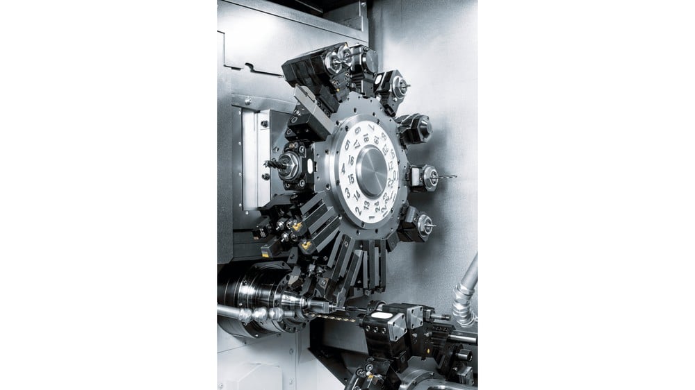

Packed with exceptional value in a single CNC lathe. The twin-spindle, twin-turret precision CNC multitasking lathe “NT-Flex” makes its debut.
This compact machine, equipped with flexible machining capabilities and a wide range of software, will turn your demands into reality.
Features and benefits:
  • High speed indexing
  • High speed spindle synchronisation
  • Execution of multiple M-codes within the same block
  • High speed rigid tapping
  • Reduction of PC-G unloading time etc.
  • Compact footprint

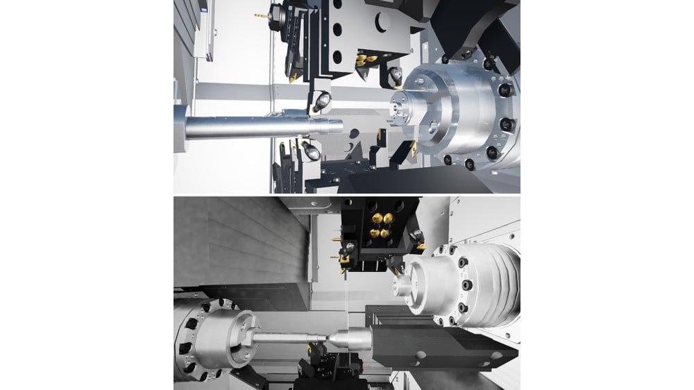

NT-Flex+ Specification(option)
“NT-Flex+” is a new specification of the NT-Flex, featuring X-axis travel on the R-spindle and an optional NC tailstock. It also adds Y-axis travel to the lower turret, enabling support for more complex machining patterns, such as superimposed machining with three tools operating simultaneously.
