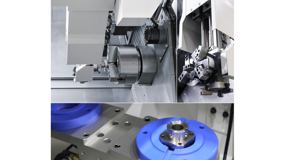

The Compact Loader, developed with an emphasis on space-saving, is a loading/unloading system built into the machine. A machine’s height remains the same even after being combined with the Compact Loader, which has the advantage of being less affected by the height limitations of factory ceilings. * The Compact Loader is available for WY-100II, WY-150, NTY³-100 and MX-100.
*The image shown in the gallery, is a combined palletising stocker “HAKO-BEI” as an option.

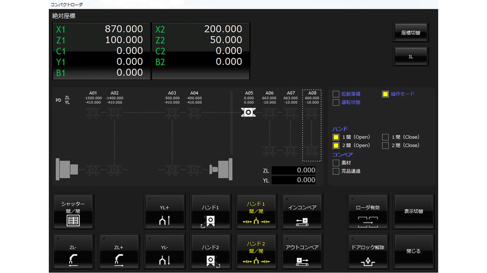

The servo type is now on stage!
The Compact Loader servo, featuring a servo-driven vertical-axis hand, is now available! The servo type offers improved travel speed and positioning accuracy compared to the conventional type. In addition, it allows users to specify teaching points, making setups even more convenient. The Compact Loader servo can be controlled from its dedicated screen. *The Compact Loader servo is available for the MX-100 only.
