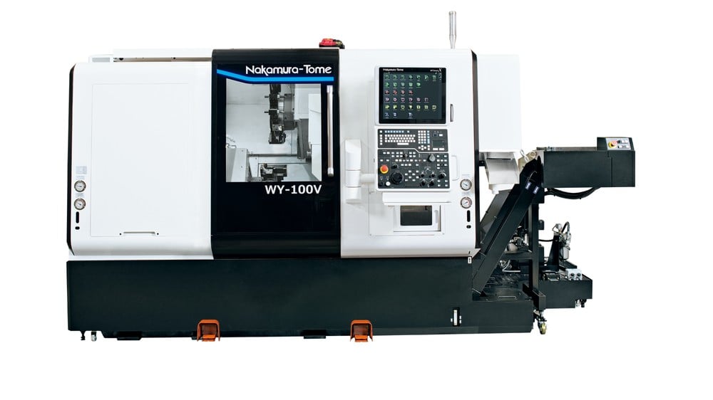

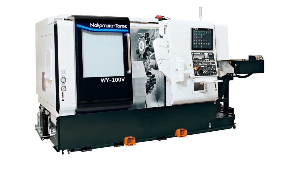

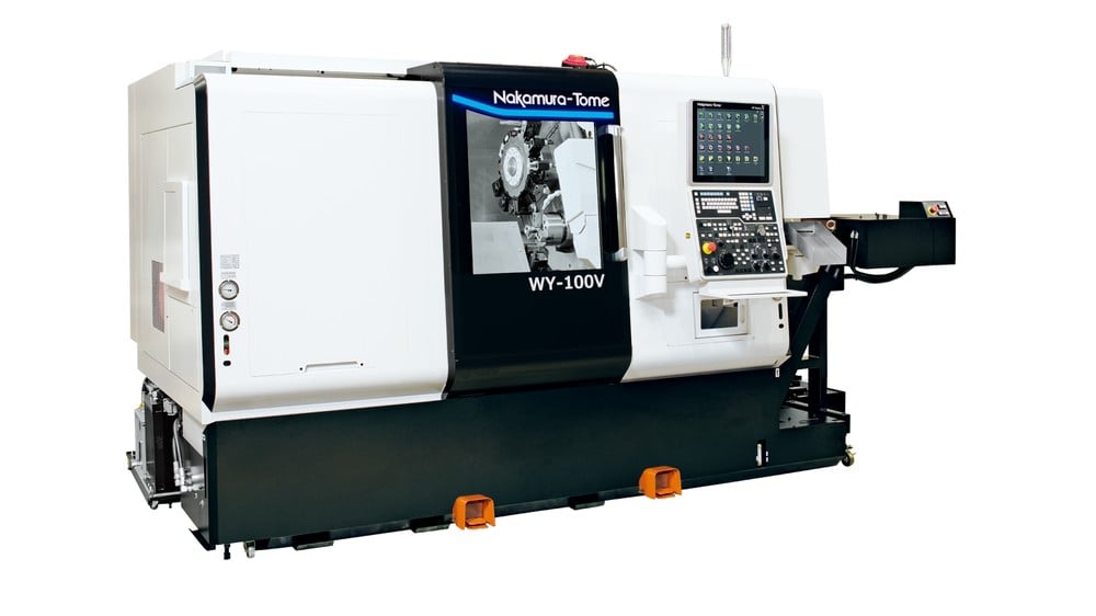

WY-100V by nakamura-tome

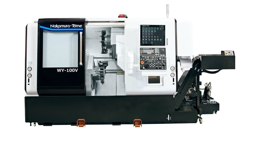

The WY-100V – faster than the fastest!

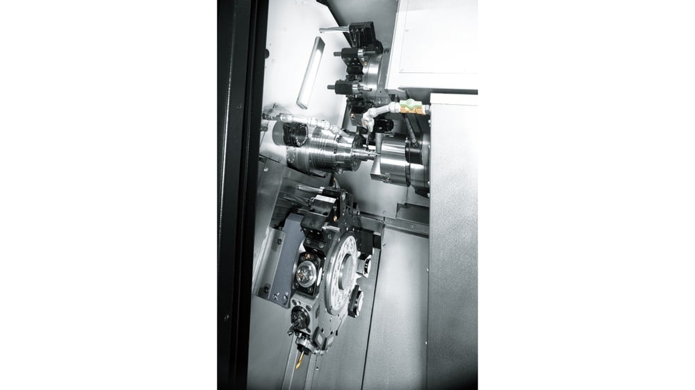

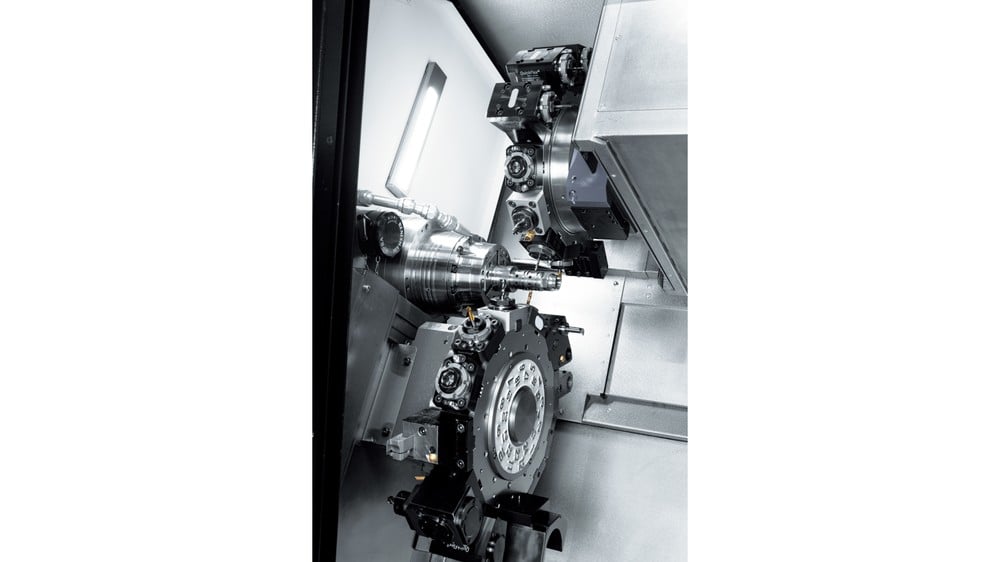

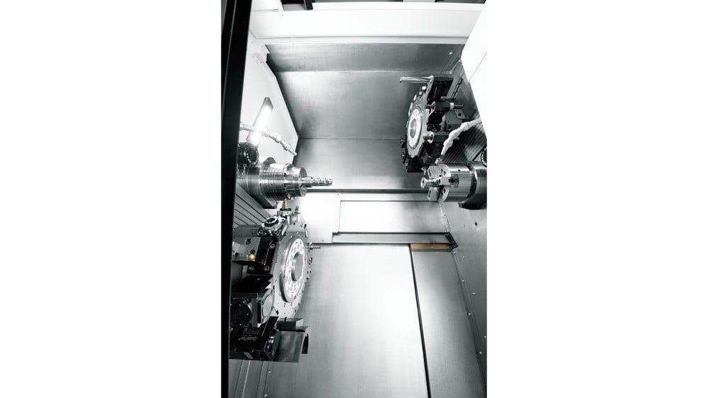

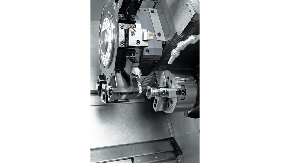

The first of the “V series” multitasking machines, with speed as the design concept behind it. Y-axis on the upper/lower turret and opposed twin spindles are standard equipment. Enhanced processing capabilities and simultaneous left/right and upper/lower machining reinforce speedy production. Furthermore, Nakamura-Tome has made software improvements to reduce idle time. The WY-100V strives to be faster than the fastest, quicker than any other machine of its type, that customers have ever experienced.
Advantages of the WY-100V include:
//     30% Reduction in Cycle Time*
//     Cycle Times are Faster Thanks to Simultaneous Machining with the L/R Spindles and Upper/Lower Turrets.
//     Both Turrets Equipped with Y-axis
//     Twin-spindle Twin-turret Multitasking Machine.
* Reduction time varies depending on the shape of the workpiece and cutting conditions.
