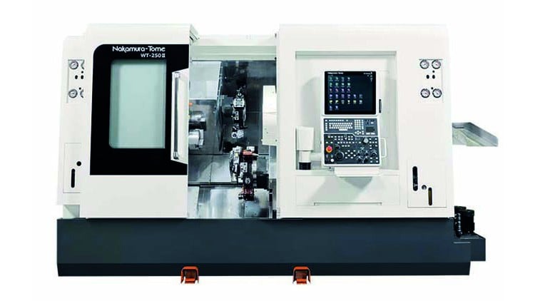

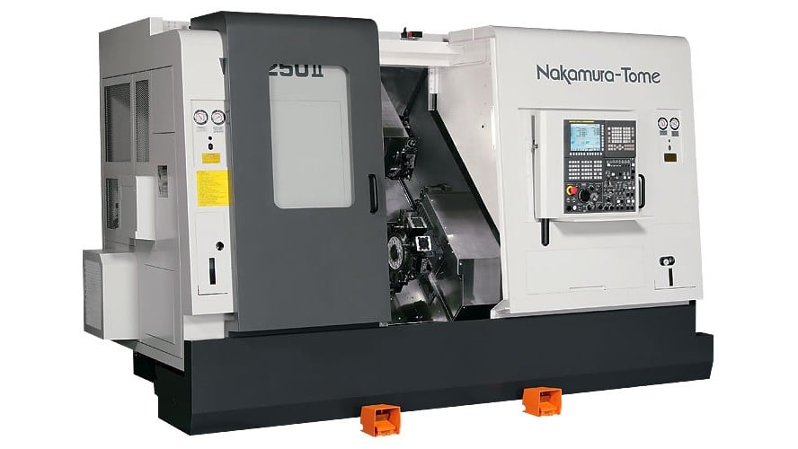

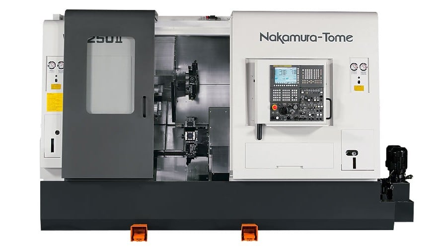

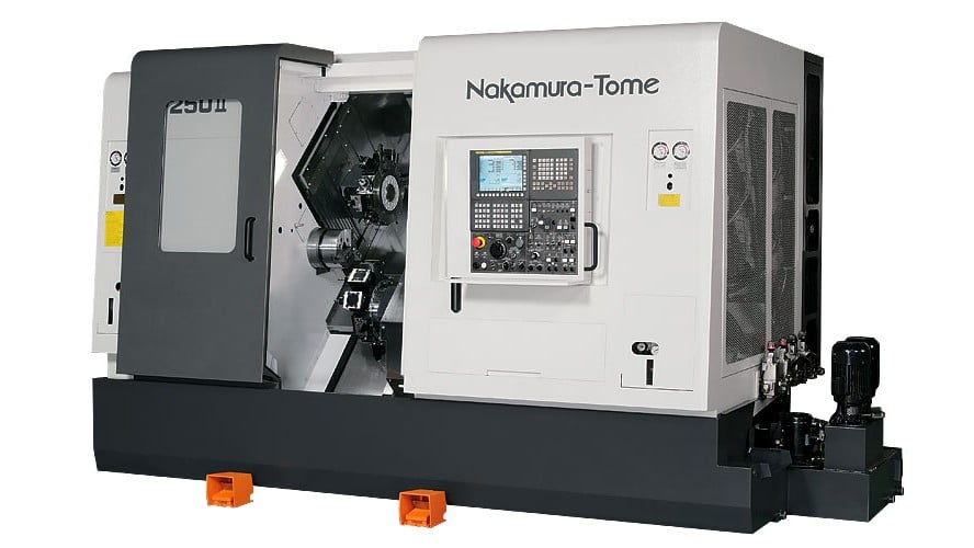

WT-250II by nakamura-tome

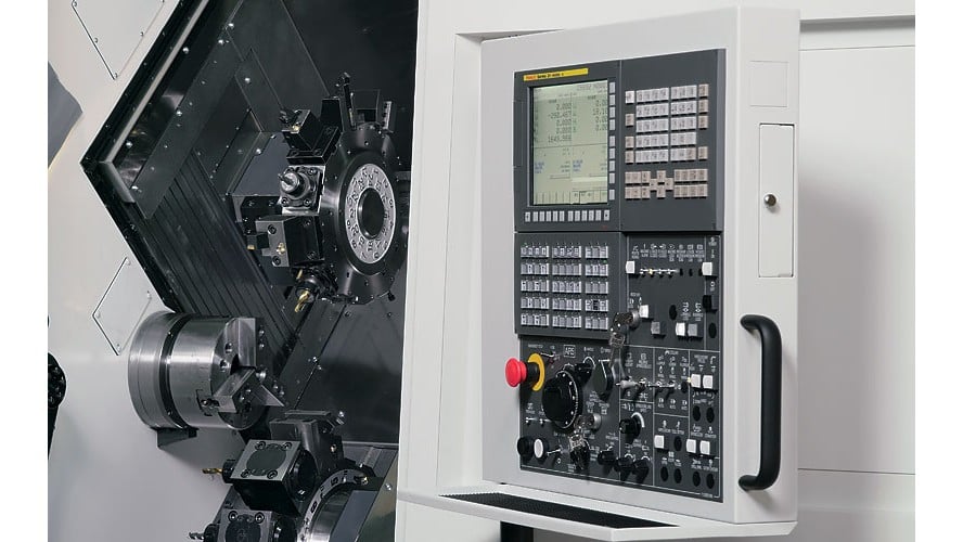

High speed, high rigidity, multi-tasking machine.

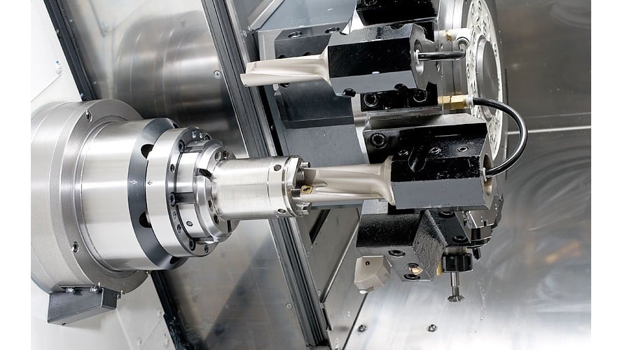

  • Up to 29.5kW cutting power available for turning shaft-work with synchronized spindles.(Left spindle motor 18.5 / 15kW, Right spindle motor 11 / 7.5kW)
  • Driven-Tool Motor Power 5.5/3.7kW,for heavy cutting with small tools.

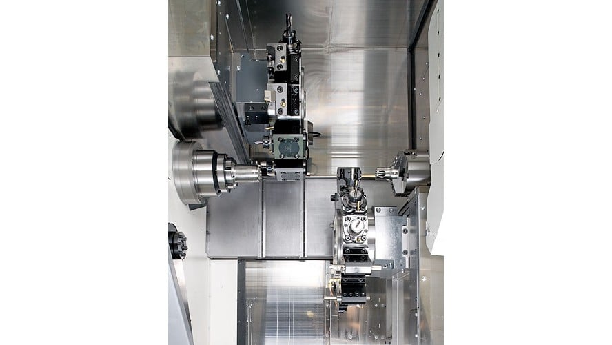

  • With upper / lower turret construction,4-axis machining as well as various other machining combinations possible on either spindle
  • With upper / lower turrets and opposed two-spindle construction, cycle time balancing and reduction is possible.
  • With up to 24 tools per turret, 48 tools can be permanently available.
Technology information
General
Machine height 2,225mm
Floor space (Length) 4,059mm
Floor space (Width) 2,314mm
Machine weight 8,700kg
Capacity
Max. turning diameter 250mm
Max. turning length 555mm
Distance between spindle nose max. 885mm / min. 265mm
Slide construction Box slideway
Bar capacity L: 65mm R: 51mm R: 65mm (op.)
Chuck size 8” 215mm 6” 165mm
