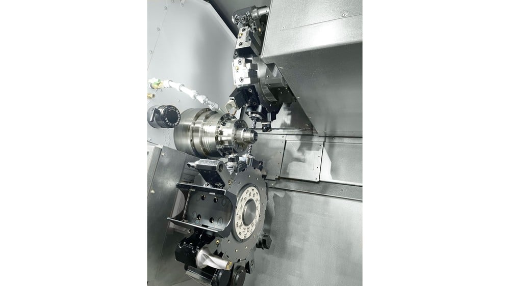

The WY-150V is the first in its class to offer a spindle capable of handling a Ø80 bar capacity, with the option of equipping a powerful motor of up to 28/15kW. Additionally, the milling motor features a standard output of 7.5/3.7kW, with a maximum rotation speed increased to 10,000 min⁻¹. This enables high-speed machining of large-diameter workpieces while maintaining both high rigidity and precision.
  • A multi-tasking machine with opposed twin spindles and twin turrets, featuring a Y axis on all turrets, as standard
  • Reducing cutting oil drastically by applying grease lubrication in all linear axes
  • High speed indexing
  • High speed spindle synchronisation
  • Execution of multiple M-codes within the same block
  • High speed rigid tapping
  • Reduction of PC-G unloading time etc.
  • Enhanced machining capability
