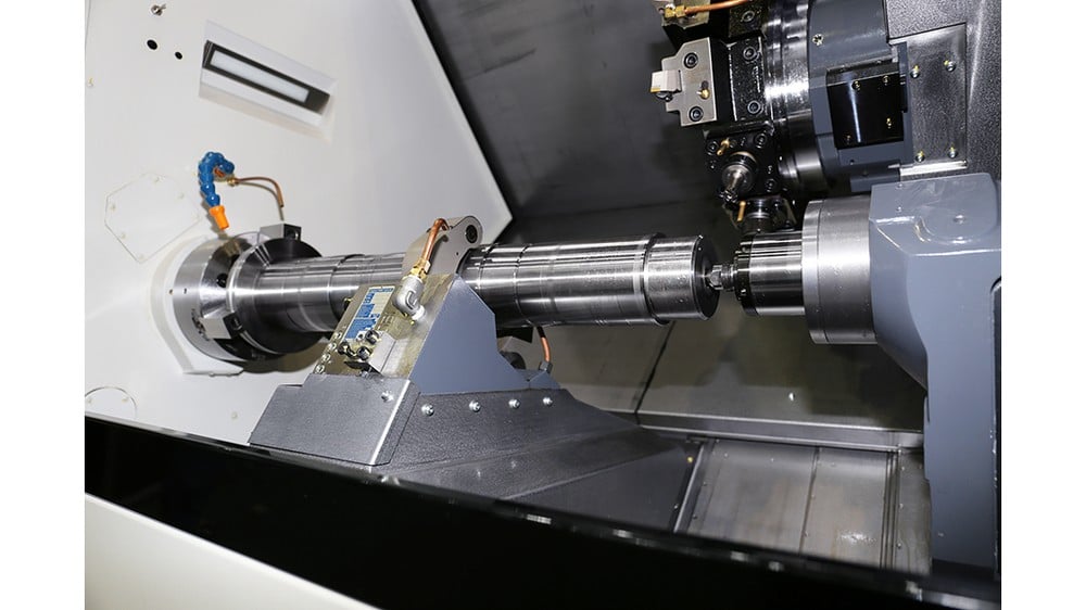

IMPORTANT NOTE: this machine as standard, is configured as a Twin Spindle – with option as a Tailstock only.

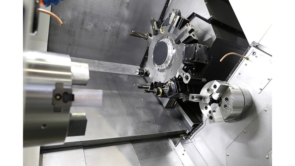

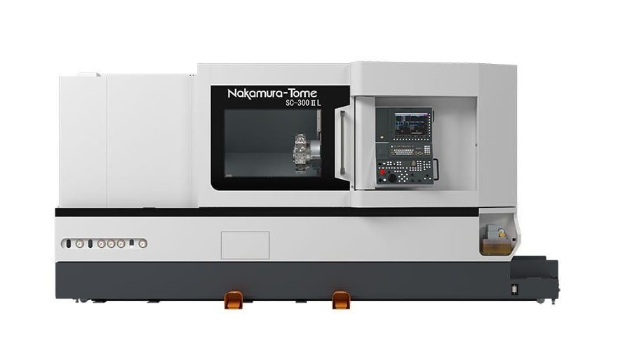

The new SC-300IIL turning centre features a large machining area with high rigidity. Available in three configurations; NC steady rest + automatic tailstock (knock type), NC tailstock and NC sub-spindle.
//   Distance between spindles 1,310mm. Max turning length 1,135mm.
//   Distance between centres 1,213.5mm. Max turning length 1,100mm.
//   Milling and Y-axis are standard.
//   All axis with high rigidity box way slide.
//   Machine Weight 11,000kg.
//   Milling motor power 7.5/3.7kW and max. speed 6,000min-1.
