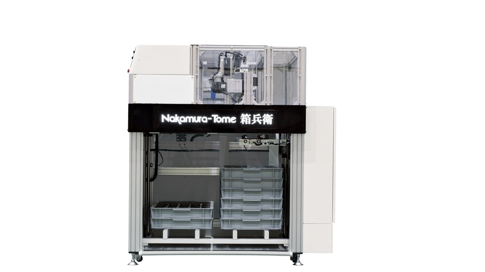

| Work stocker – Hako-Bei by nakamura-tome
Hako-Bei work stocker from Nakamura-Tome -completing all tasks from transporting cutting materials to palletising with a single device.
Work Stocker for Unmanned Automation. The work stocker can be chosen according to the machined parts. A quality control chute is available to control parts during automatic cycle.
