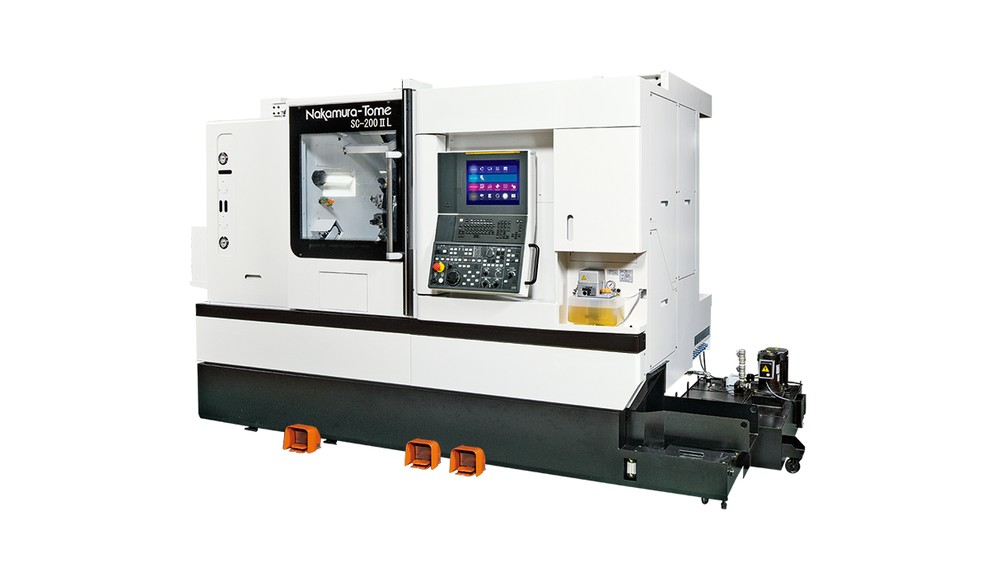

SC-200IIL by nakamura-tome
IMPORTANT NOTE: this machine as standard, is configured as a Twin Spindle – with option as a Tailstock only.
The new SC-200IIL turning centre inherits many of the main specifications of the recently launched SC-200II and its concept of ‘Next level machining’. However, the SC-200IIL expands the distance between centres – evolving into a machine capable of machining long workpieces. This development allows users to select the R-side specifications from the sub-spindle or NT tailstock units. The SC200II has a maximum turning diameter of 390mm and a 510mm distance between spindles, the new SC-200IIL increases this distance to 715mm between centres with 800mm between spindles.
Advantages of the SC-200IIL include:
//    8” Class Single-Turret Carrying Out Great Machining Rigidity and Stability.
//    Maximum turning diameter of 390mm and a tool swinging diameter of 620mm, equipped with a 15/11kW (op. 18.5/15kW) spindle motor.
//    High rigid slant bed with box-way slides, it carries out great machining rigidity and stability.
//    The distance between centres has been increased to 715mm (distance between spindles: 800mm).
