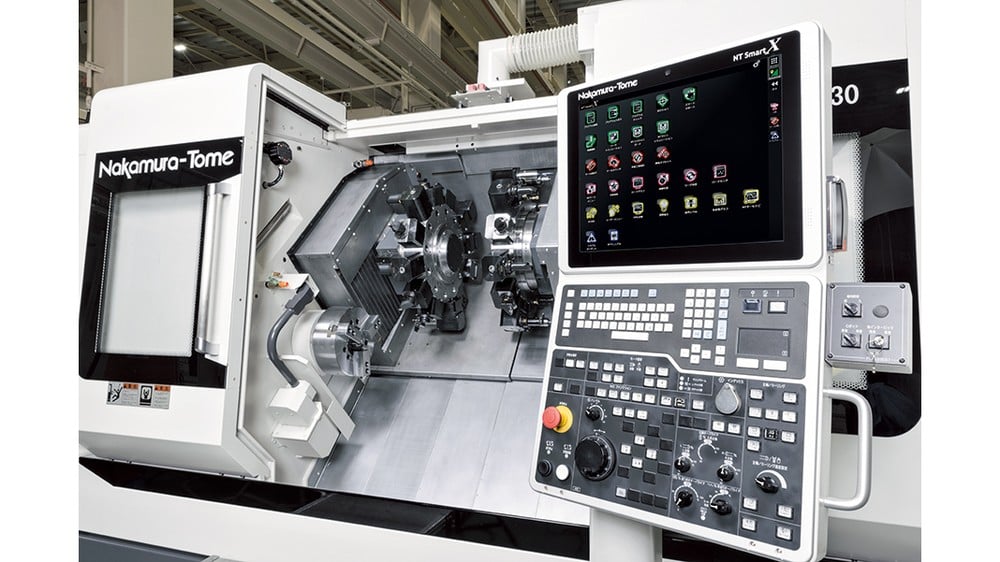

TW-30 by nakamura-tome
Two-Turret Machine (TW) – Perfect for Heavy Duty Machining
Best suited for all sorts of heavy duty machining. A fantastic machine, which boasts rigidity and great bar capacity capability.
Features and benefits:
  • Two-turret, opposed twin-spindle machine.
  • High precision direct transfer operation on Right spindle by servo motor torque control technology.
  • Simultaneous cutting on L/R opposed twin-spindles ensures faster cycle times.
  • 24 tool stations, the number of tools can further increased by using multi-holders.
  • Non-lift servo-driven turret.
