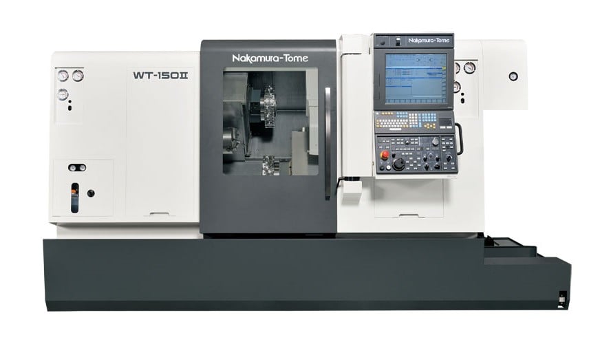

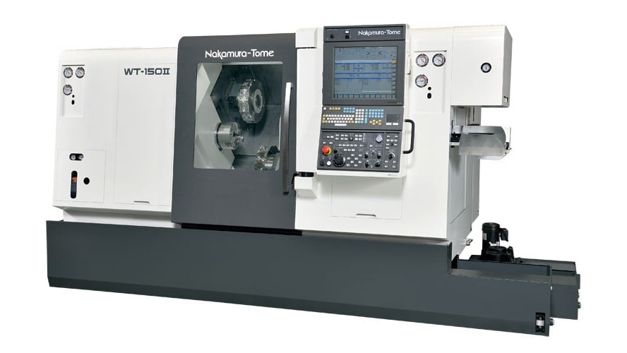

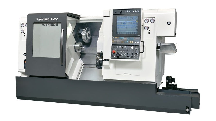

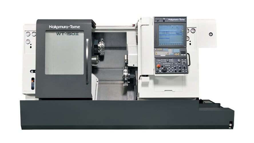

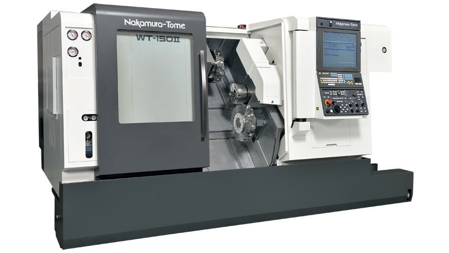

WT-150II by nakamura-tome
High speed, high rigidity and compact multi-tasking machine.
  • Up to 26kW cutting power available for turning shaft-work with synchronized spindles.(Left spindle motor 15/11kW, Right spindle motor 11/7.5kW)
  • Driven-Tool Motor Power 5.5/3.7kW,for heavy cutting with small tools.

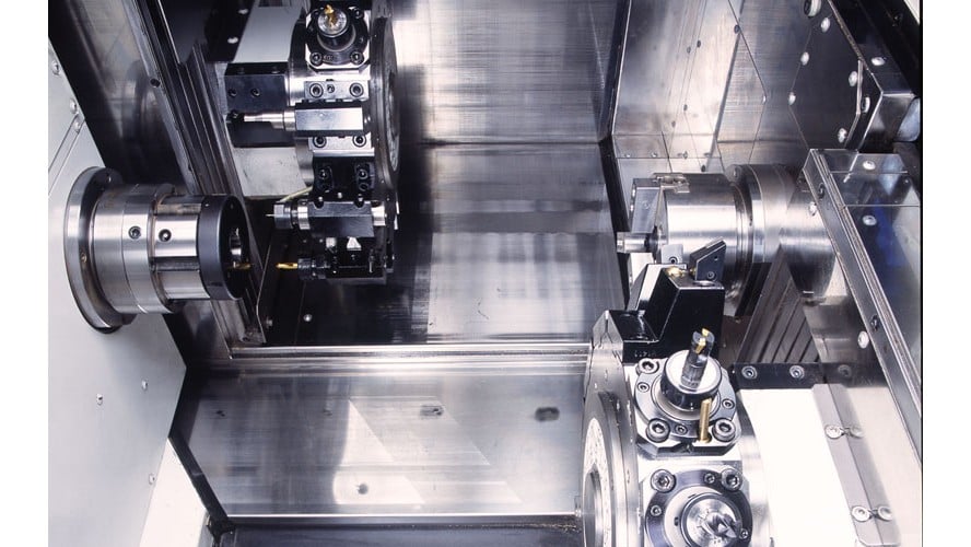

  • With upper / lower turret construction, 4-axis machining as well as various other machining combinations possible on either spindle
  • With upper / lower turrets and opposed two-spindle construction,cycle time balancing and reduction is possible.
  • With up to 24-tools per turret,48 tools can be permanently available.
