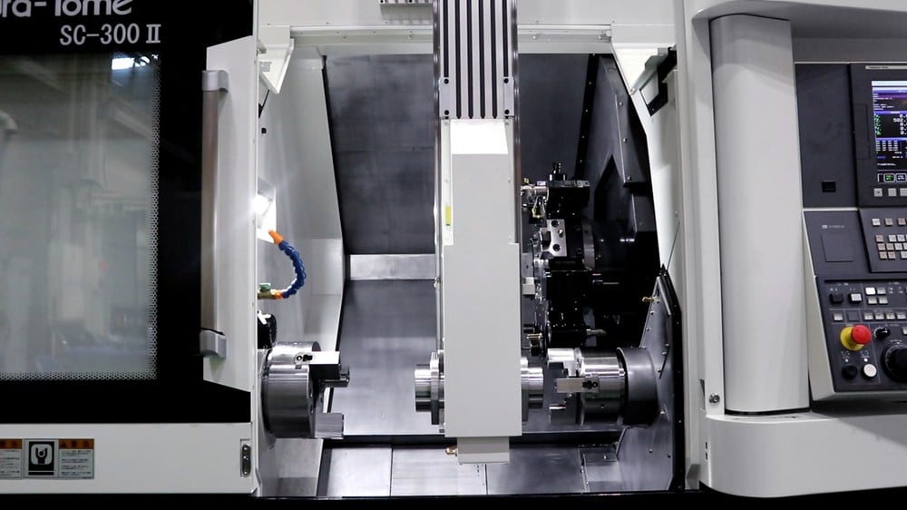

Gantry loader GR-210 high-speed automation from Nakamura-Tome.
Transport time reduced by 27% – The fastest transfer speed in its class, time savings lead to improved productivity.
Advantages include:
  • Reduction in transfer time by 27% compared to previous model.
  • Handling time could be drastically reduced by increasing transfer speed and signal relaying speed.
  • Idle time is reduced.
Notes:
This is an automation product only and does not include the machine.
For machine compatibility please see the table below “machine compatibility”.
Technology information
DESCRIPTION
Unit
10kg
20kg (op.)
Part diameter (flange)
mm
Ø20 ~ 220
Part diameter (shaft)
mm
Ø20 ~ 100
Part length (flange)
mm
20 ~ 100
Part length (shaft)
mm
50 ~ 200
Part weight (flange)
kg
10 x 2
20 x 1 (op.)
Part weight (shaft)
kg
10 x 2
20 x 1 (op.)
Loading time
Sec.
6.0
10.5
Unloading time
Sec.
6.0
10.5
