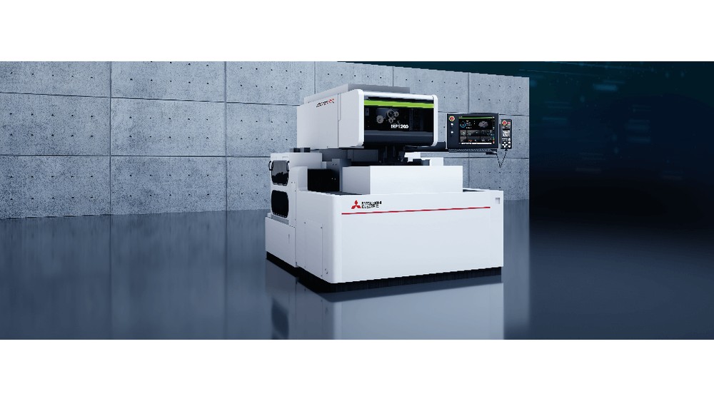

MP1200 Connect by mitsubishi-electric
The MP Series has the highest precision of water wire erosion from Mitsubishi electric with a pitch accuracy of +/- 0.001µm. The high frequency digital fine surface generator produces the best surface finishes available. Ease of access with the 3 sided work tank and all round casting cooling backed up with the Tubular drive technology with 12 year positional warranty delivers the highest quality and results.
Key benefits include:
  • Travels 400 / 300 / 220
  • Max work piece 810 x 700 x 215
Standard Equipment:
  • Tubular Shaft Drives with linear scales (X / Y / U / V)
  • Control M800 with 19” full-touch monitor
  • Hand pilot with configurable LCD monitor
  • Digital AE II generator
  • Fine finishing generator H-FS
  • Digital fine finishing generator SD-FS
  • Hardened 4-side table
  • Digital electricity meter / filter pressure sensor
  • Ethernet/DNC/FTP
  • Preparation for automation
  • McAfee AntiVirus embedded
  • Operating data output
  • 3D CamMagic on-board
  • Corehold technology
  • Job scheduler / Job scheduler+
  • mcAnywhere Contact + light
  • Sleep mode
  • Three-side lifting tank
  • mcAnywhere service
  • Angle master Advance II – basic kit inc. aligning device
Technology information
Machine MP1200 MP2400
Travel (X / Y / Z) in mm 400 / 300 / 220 600 / 400 / 310
Travel (U / V) in mm 120 / 120 (+/- 60) 150 / 150 (+/- 75)
Taper angle (workpiece height) in °/mm 15 / 200 30 / 87 15 / 260 30 / 110
Max. workpiece dimensions (W x D x H) in mm 810 x 700 x 215 1050 x 820 x 305
Max. workpiece weight in kg 500 1500
Table dimensions (W x D) in mm 640 x 540 840 x 640
Table layout Hardened 4-side table
Possible wire diameters in mm 0.1–0.30 (0.05–0.3 variant option)
Wire spool capacity in kg 10
Automatic wire threader / wire chopper Yes / Yes
Overall dimensions (W x D x H) in mm 2025 x 2760 x 2015 2684 x 3030 x 2150
Machine weight in kg 2700 3800
Mains voltage 3-phase 400 V/AC ± 10 %, 50/60 Hz, 20 kVA
