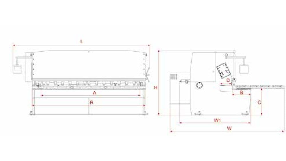

D – Throat depth
mm
50
50
50
350
350
50
50
Oil capacity
Lt
200
200
330
410
450
200
330
Front arms
Unit
2
2
2
2
2
3
3
C – Table height
mm
865
865
845
818
886
865
818
B – Table width
mm
500
580
600
550
570
580
550
R – Table length
mm
3515
3515
3550
3580
3670
4510
4520
L – Length
mm
4110
4200
4280
4550
4450
5230
5350
W1 – Width
mm
2200
2250
2300
2250
2260
2300
2250
W – Total width
mm
3700
3600
3600
3825
3400
3600
3650
H – Height
mm
2100
2100
2350
2250
2450
2150
2250
Weight
Kg
7300
9050
11800
14580
20480
11460
16300
