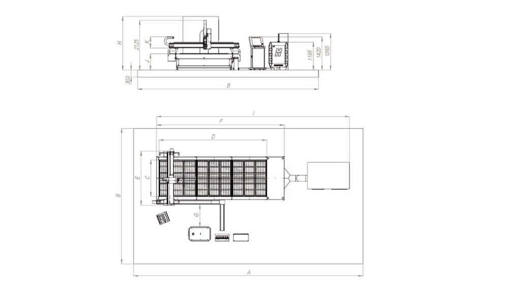

Technology information
MODEL
Unit
PL-C 1530
PL-C 2040
PL-C 2060
PL-C 20120
PL-C  25120
PL-C 30120
A – Machine installation length
mm
10000
11000
13000
19500
19500
19700
B – Machine installation width
mm
6500
7700
7700
7700
8200
8700
C – Part cutting area width
mm
1580
2080
2080
2080
2580
3080
D – Part cutting area length
mm
3100
4100
6100
12100
12100
12100
E – Machine width
mm
2500
3000
3000
3000
3500
4000
F – Machine length
mm
4240
5240
7240
13240
13240
13240
G – Distance between machine & power supply
mm
1500
1500
1500
1500
1500
1500
H – Filter height
mm
2200
2200
2200
2200
2200
2200
I – Machine length with filter
mm
9444
10424
12424
19044
19044
19422
J – Table height
mm
700
700
700
700
700
700
K – Z axis stroke
mm
220
220
220
220
220
220
Weight without filter
Kg
3000
4500
6000
11500
13000
15000
