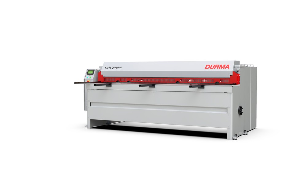

MS Series Reducer Guillotine Shears by durma
Durma MS Series Reducer Guillotine Shears
Guillotine shear is used to shear or cut various metals. Guillotine shears can have very different characteristics. They can have varying cutting capacities. Sheet metals of different thickness can be cut. Finding a guillotine shear that suits your needs is essential.
Durma MS Series Guillotine Shear offers high performance, advanced technology and economical solutions.  Durma MS Series Guillotine Shears provide our customers a reliable, effective and economical solution. Knowledge, ability and experience are the essentials of developing mechanical and electronic drive components, which are united in producing the Durma MS Series Guillotine Shears. You can safely use the blade adjustment feature at any point with its maintenance-free and impact-resistant structure. Product performance and quality are never compromised while manufacturing the MS Series. We as Durma know that you deserve adjustable, precise and reliable machines and the MS Series are here to provide you the best manufacturing experience.
What Are the Advantages of the Durma MS Series Reducer Guillotine Shear Machine?
Durma MS Series products provide a reliable, effective and economical solution. Product performance and quality is never compromised while manufacturing MS Series. Durma MS Series will provide high quality cuttings with precision. They are designed to fit world standards. They have high performance yields.
Durma MS Reducer Guillotine Shear is fast. The machines are designed to have high accuracy. MS Series Shears are adjustable, maintenance free and crash-proof. They are designed to be secure and dependable machines. MS Series shears, equipped with high-tech products which will offer you exact solutions. They are easy to program, and have maximum speed. They are also designed to consume low energy. MS Series shears will save you time, energy and manpower.
