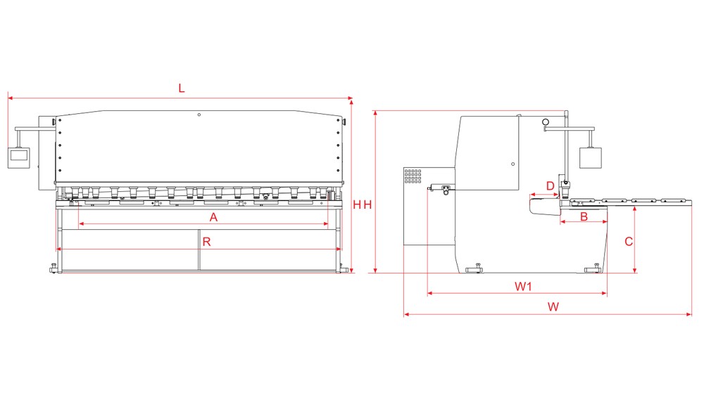

A – Cutting length

D – Throat depth

C – Table height
mm
820
835
840
840
820
835
1000
900
950
B – Table width
mm
494
559
554
580
494
589
630
630
650
R – Table length
mm
3280
3380
3420
3460
4400
4400
4385
6370
6375
L – Length
mm
4100
4200
4130
4100
5150
5200
5890
7300
7400
W1 – Width
mm
2050
2100
2210
2300
2100
2150
2100
2150
2200
W – Total Width
mm
3650
3560
3820
3700
3550
3560
3625
3400
3700
H Height
