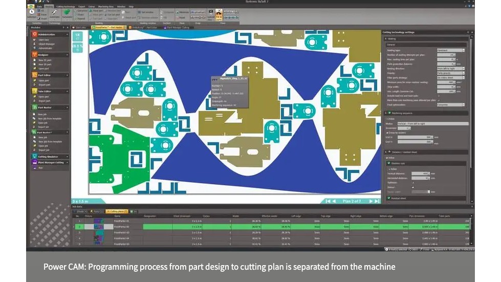

Power CAM Software, a flexible programming software solution. DNE software is optimally designed for the requirements of sheet metal processing.
