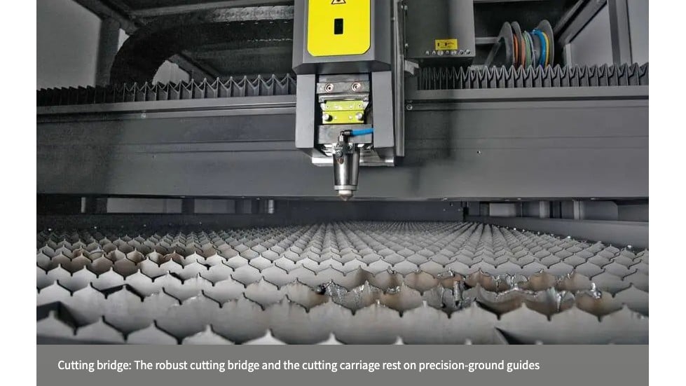

LC3 – 2kW – 6kW by dne-global
The Best value machine for your laser cutting applications
Wide range of applications from thin to thick. In addition to steel, stainless steel, and aluminium, non-ferrous metals can also be processed in excellent quality.
More profit per part, low investment combined with comparatively low operating costs and low maintenance requirements.
High ease of use and intuitive process control enables fast access to fibre laser technology. Using a 21.5-inch touch screen, DNE’s ByVision Cutting software is operated just as simply as a smartphone.

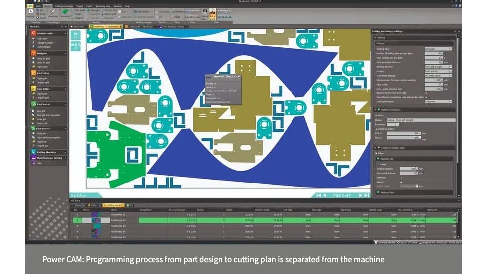

Power CAM Software, a flexible programming software solution. DNE software is optimally designed for the requirements of sheet metal processing.

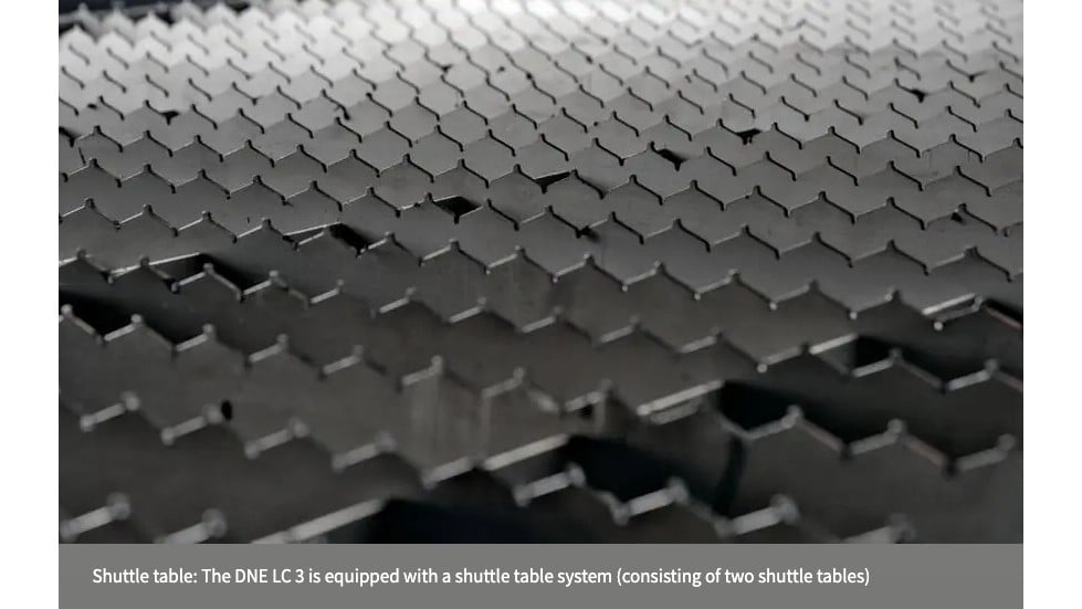

Table changeover time
Sec
24
24
24
24
