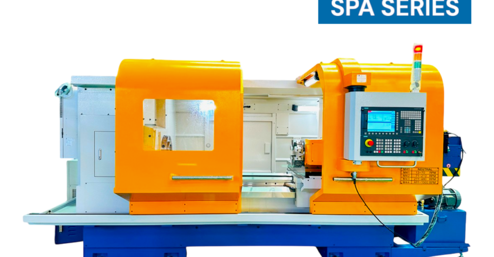

CNC Heavy Duty Precision Lathe is a very popular product line in metal industry. The spindle motor power in the series is transmitted to the spindle through pulley, belt and 4-step gear sets. It could perform heavy duty machining with high speed and high rigidity.
| Description \ Model | SPA600 | SPA670 | SPA770 | |
| Swing over bed | 600 mm | 670 mm | 770 mm | |
| Swing over cross slide | 310 mm | 380 mm | 480 mm | |
| Width of bed | 400 mm (16”) | |||
| Distance between centers | 1500 mm / 2000 mm / 3000 mm | |||
| Spindle bore | Ø80 mm (3”) / Ø104 mm (4”) | |||
| Spindle nose | A2-8 / A2-11 | |||
| Spindle speeds (4 Steps) | 16-1500 rpm / 13-1200 rpm (Chucks are NOT Considered) | |||
| Ball screw diameter | X-axis : Ø32 , Z-axis : Ø50 | |||
| Rapid Travel | X-axis : 5 m/min , Z-axis : 5 m/min | |||
| Max x-axis travel | X-axis : 5 m/min , Z-axis : 5 m/min | |||
| Max z-axis travel | 1300 mm / 1800 mm / 2800 mm | |||
| Tailstock spindle travel / Quill | 230mm / Ø95 | |||
| Tailstock spindle taper | MT#5 | |||
| Controller | FAGOR 8055i | FANUC 0i-TF | SIEMENS 828D | |
| Spindle motor | 15KW (FM7 A150) | 15KW (αi15) | 15KW (βi15) | 15KW (1PH8133) |
| X-axis servo motor | FKM 42 (1.9KW) | αι8 | βι8 (1.2KW) | 1FK7060 (1.1KW) |
| Z-axis servo motor | FKM 44 (3.6KW) | αι12 | βι12 (1.8KW) | 1FK7063 (1.9KW) |
| Coolant pump motor | 0.7KW (50Hz) / 1KW (60Hz) | |||
| 16″STANDARD ACCESSORIES | 16″OPTIONAL ACCESSORIES |
| CNC controller: FANUC, FAGOR or SIEMENS | 3-Jaw Chuck |
| AC spindle motor | 4-Jaw Chuck |
| Auto lubrication system | Face Plate |
| Electric Cabinet Heat Exchanger | Hydraulic Power Chuck |
| Coolant system | Double Chuck System |
| 2-door Splash guard | Steady Rest |
| Work light | Follow Rest |
| Spindle sleeve and Tool centers | Milling Device |
| Leveling bolts & pads | Hydraulic Spindle Orientation |
| Tool box with oiler, spare fuse, paint & tools | Boring Device |
| Operation & service manual | Hydraulic 4-way Tool Post |
| Hydraulic V8 Turret | |
| Hydraulic Tailstock | |
| Chip Conveyor | |
| Electric Cabinet Air Conditioner | |
| Spindle Oil Cooler | |
| Full Guarding |
