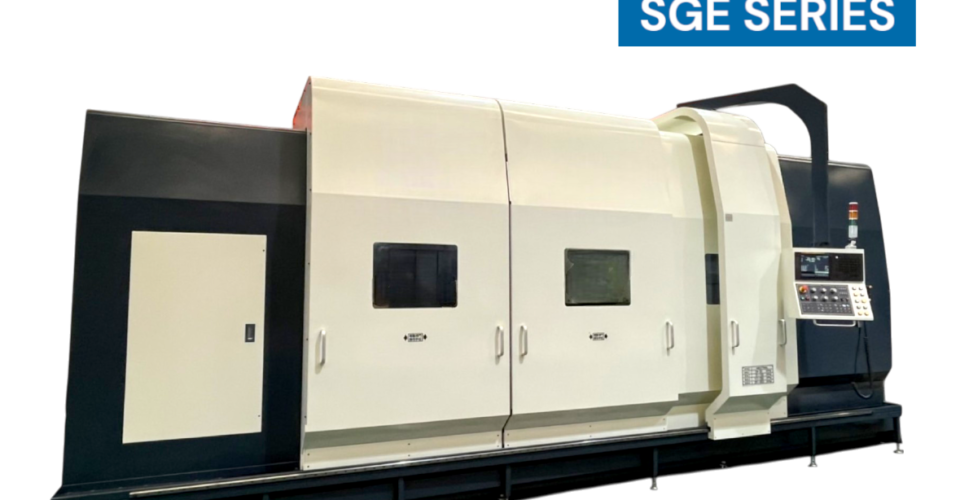

The tailstock, steady rests and the carriage are designed to sit on two separate pairs of guide ways which effectively limit the interference when the carriage passing by the tailstock.
In addition, the carriage is able to move next to both headstock and tailstock so that increase the flexibility in tooling arrangements and clamping.
Besides, it is not necessary to remove steady rests or unclamp work-piece from the chuck amid the process A to process B for without wasting any time.
Moreover, the tailstock quill doesn’t need to overhang long to approach work-piece which is a plus to maintain the stiffness due to the longer overhang, the weaker quill stiffness.
It is optional to equip with a second carriage either to do turning simultaneously, to have a milling station, or to have an individual boring carriage.
